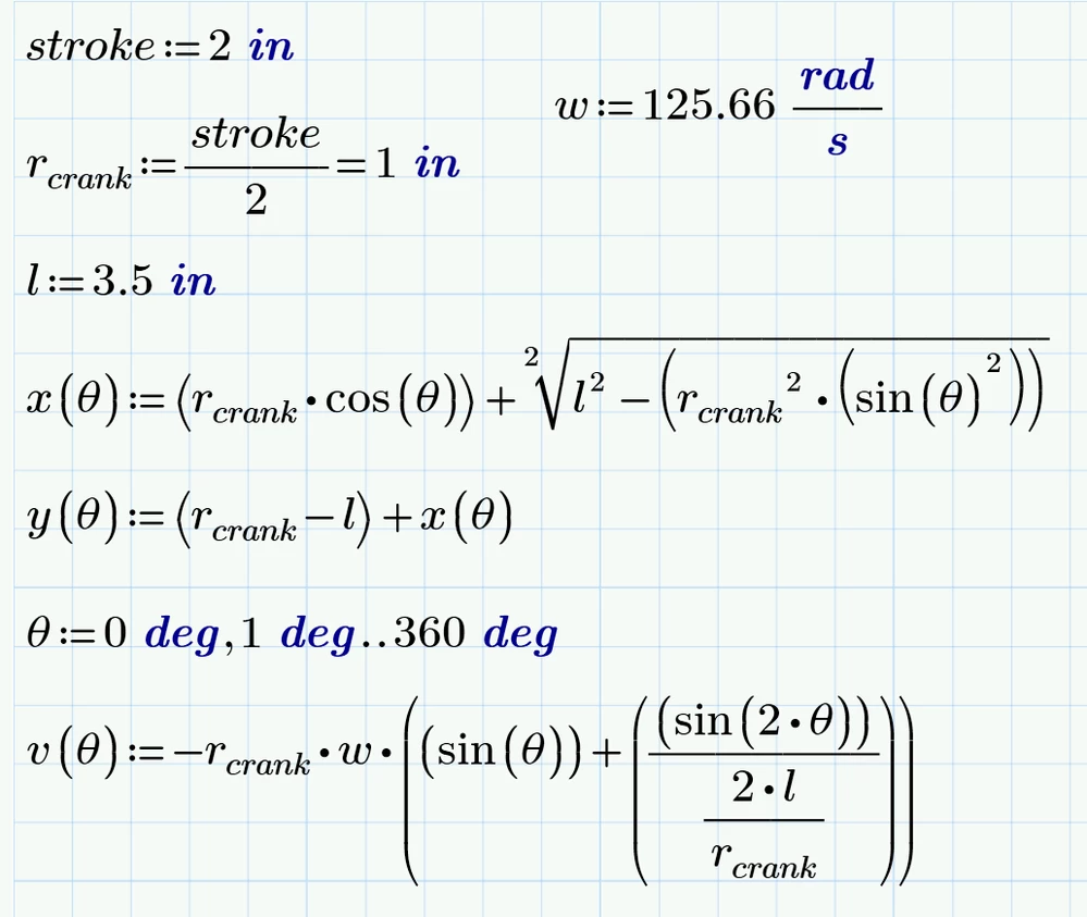

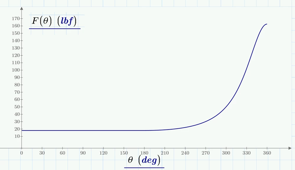

When I'm trying to graph F(theta) an error tells me that the value must be a scalar and by error tracing, I found that in the first part of the if statement, the same error pops up. If anyone could help me out here that would be great.
Change the begin
BeginBeginEndEnd

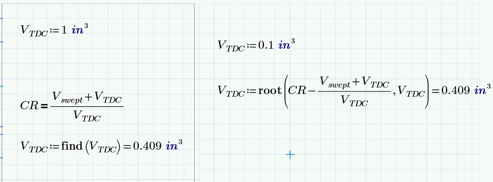

And second!
Better use not the Find but root function.
The Find is for 2, 3 and more equations.
And The root works in Mathcad Express - the free of charge version of Prime
