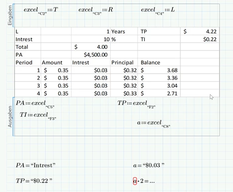

I am getting error this should be scalar or matrix as I am trying to evaluate it with a number

No, you don't! You are trying to multiply a string, a text (variable a) by a number (2). This can't work.
You can tell that variable a is a string by the double quotes you get when you evaluate it via a=...
There is a function to convert a string into a number (str2num()), but you would first get rid of the currency sign ($).

This is the situation which you saw when you saved the sheet. a and TP are returned as strings - because of the $ character I guessed at first, but I am not sure about that anymore.:

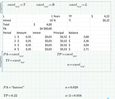

When I simply let the sheet recalculate (F9 or F5) the display suddenly changes to
TP and a are now just scalars, numbers and of course you can do calculations with them.
Excel now shows a comma to separate the whole and fraction part of the numbers because thats the way my windows is setup to and Excel by default uses this setting.
Have you created the sheet yourself or was it just given to you by someone else? Have you tried to recalculate the sheet?
For completeness sake: I am using Prime 6, Windows 10 German (hence the comma instead of the dot) and an older local (not 365) Excel 2016.
