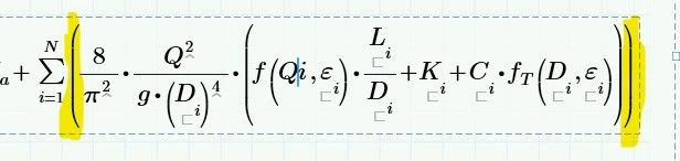

This value must be a vector
In the solve block there is an issue with my vectorized values where even if they are vectorized the solve block will still ask them to be in vector form.
Also, for some odd reason I believe my if statement asks for a scalar result even though I am following my professors' steps in which his if statement works.
Attached you will find the worksheet in question.
Thank you.

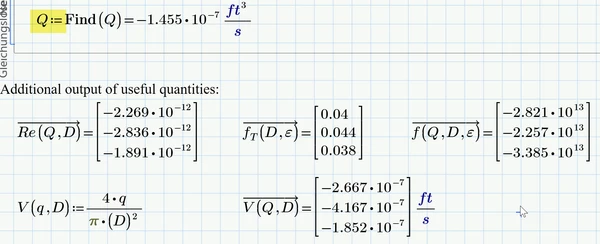

The extra pair of parentheses you added are not necessary in Prime,  but I, too, would recommend using them for better clarity.
You (resp. @JR_9175191 )  forgot to assign the result to the variable Q so the calculation below the solve block use the guess value which you duplicated in front of the sheet
I would also recommend to use explicit vectorization every time we want vectorization to be done and not rely on Primes implicit vectorization.

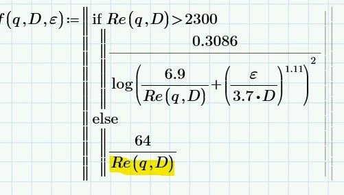

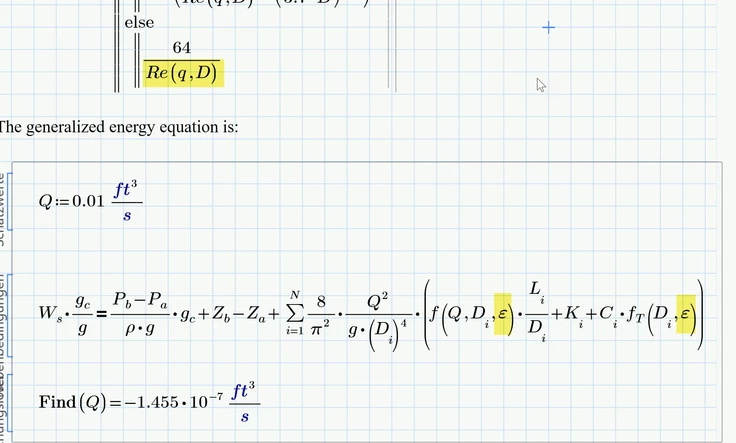

Not sure if a negative value is what you expect but you had a least two errors:
1) Your function f() was defined wrongly as at the end you simply typed "Re" instead of the full function call
2) epsilon is defined as a scalar, its not a 3x1 vector, so you should not use it as if it were a vector
Maybe the way I fixed your function f() is not the way it finally should be ...
Maybe W.s is not supposed to be zero?

Changes I made are:
