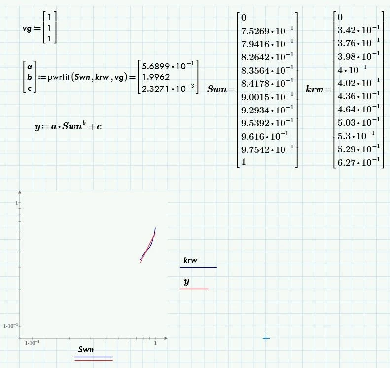

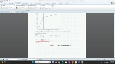

Here is the pwrfit() to the data.
Cheers
Terry

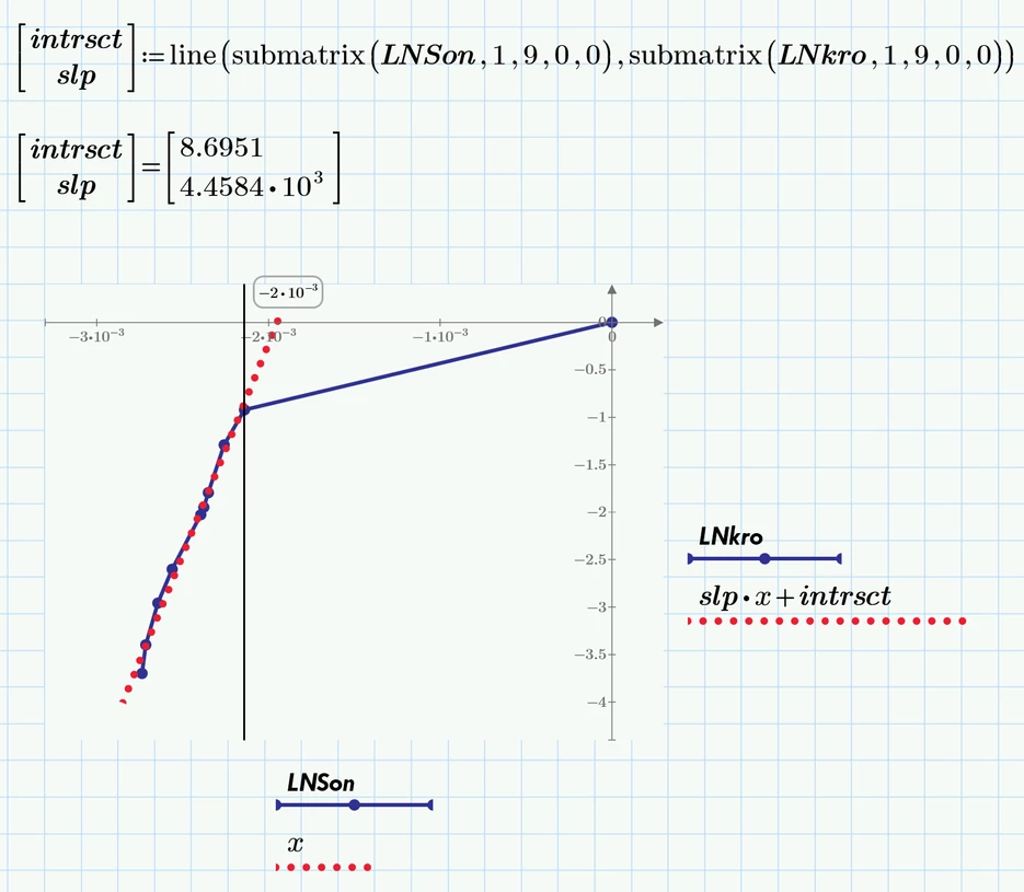

Apr 20, 2023 1:38 AM UTC

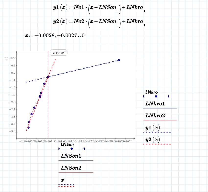

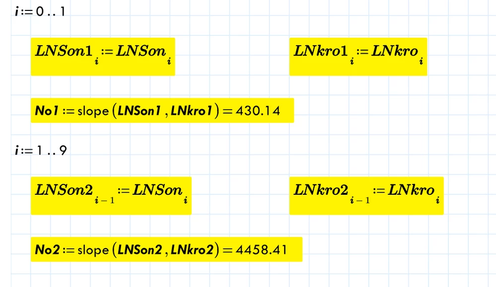

You may use "submatrix" to get only parts of your vectors and use "slope" on them.
The two slopes you seem to be looking for are
You may also use "line" to get slope and intersect for the linear regression in one go and use them to draw the line fit
3-Newcomer
Apr 20, 2023 12:35 PM UTC

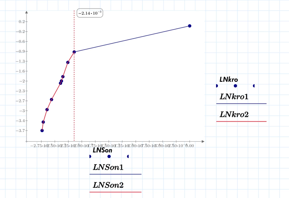

thanks, Mr. Werner that's so helpful. But the reason I exclude some values from the vector is that I can't conduct log(0), I tried to do a program in Mathcad to fulfill this but I couldn't make it, can you please help me out to do this issue in a program that calculates the slope of between the log of the data with excluding any value that equals to zero

Apr 20, 2023 1:23 PM UTC

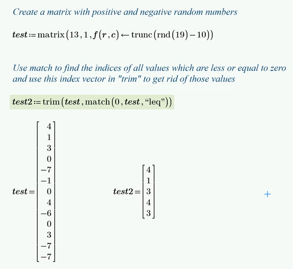

Here is a way to eliminate all values in a vector which are zero or negative:
The method will fail if no values of zero or below are in the vector because match will fail in that case.

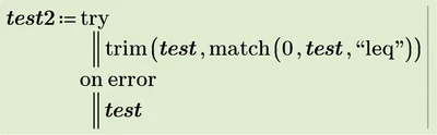

You can deal with this problem by using "try ... on error..."
One drawback still remains - if all values are zero or negative, this routine returns the vector unchanged instead of returning an error or Nan or the like. Don't think this would be an issue in your application, though.
