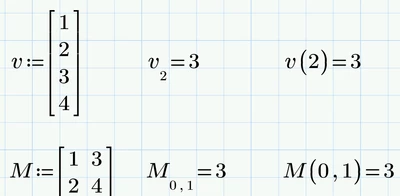

Mathcad uses a subscript (left square bracket "[") to get  Capture2.JPGinstead.
In Prime the element of a vector or matrix can be accessed by a matrix subscript as we are used to, but alternatively also via function arguments. Personally I dislike the latter as a vector isn't a function and IMHO this notation is confusing but its valid in Prime.
But you are correct anyway that the assignment is one of the errors in the sheet, because the function-approach is only allowed on the  right-hand side of an assignment.  In the program one has to use the matrix index.

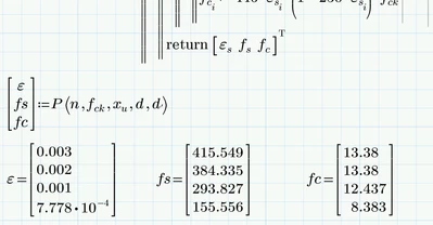

March 7, 2020
Werner's sheet converted to Prime 3.0 is attached.

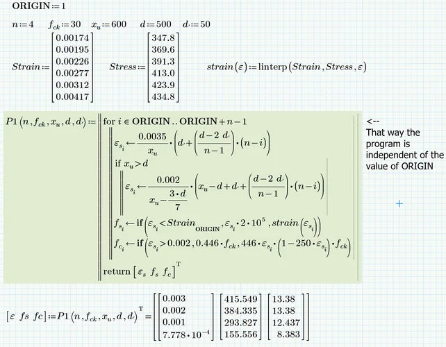

March 8, 2020
Here is a streamlined version of your program. You may put the definition of the interpolation function "stress" at the top of the program, but I'd prefer to have it outside.
I replaced two if statements by the space saving if-function (a version which uses if statements only is included in the attached Prime 6 worksheet.
