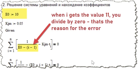

Werner_EAnswer
Jan 18, 2021 1:21 AM UTC
You may consider changing the value of E0 to avoid the division by zero!

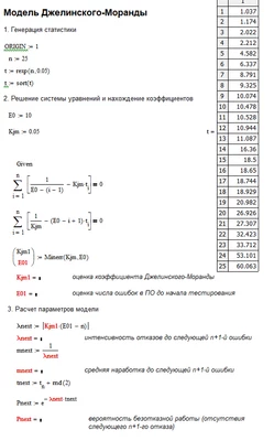

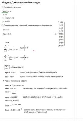

Jan 17, 2021 8:46 PM UTC
I attached two sheets, the one that is working, and the one that is not.
Werner_E25-Diamond IAnswer
Jan 18, 2021 7:50 AM UTC
Thank you!
