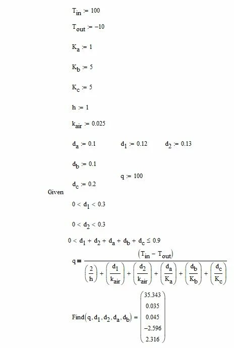

You've not learned that all of the constraints have to come after the "given" statement?  Where is "Find"?
Go read the help files about how to set up a solve block!
Or are you just dumping on this forum?

how can i solve range problem.

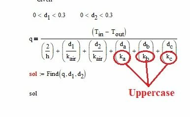

the Ks are all uppercase or lowercase.....

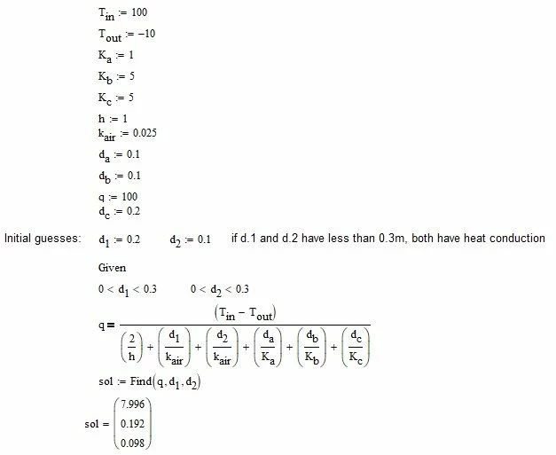

Thank you!!
