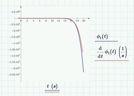

I am unable to get the evaluation of Derivative in attached worksheet.  How do I get it evaluated?

August 22, 2023
Your sheet does not work - maybe due to an error in the protected area. First error message is that rho is not defined.

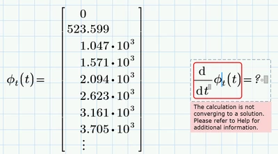

But the problem is clear anyway: A solve block with odesolve returns a numerical solution, not a symbolic one. You don't get a symbolic function definition and so you can't demand a symbolic derivative.
All you can do is to numerically evaluate the functions at positions within the interval from 0 to 20 s and you may also numerically evaluate their derivatives as you already did in the plot. So Phi(2s)= will work, but Phi(t)= or Phi(t)-> can't - apart from the fact that you already defined t as a range!

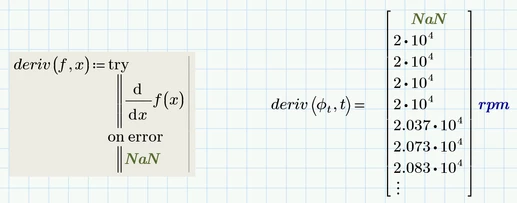

The derivatives may fail at the end postions (0s and 20s) because the numeric algorithm needs neigbour-points which do not exist at the ends of the interval. Nonetheless you may filter the failing values and still see the other values or you define a vector of t-values which does not include the problematic end values.

The calculation of the derivatives fails because of the end values (0s, 20s) as already explained
You may fix this by using try & catch
It may be worth to define a small utility function to do that job

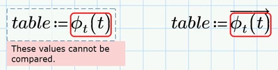

You can't assign these values to a variable for later use as its NOT a vector! So of course vectorization does not help at all
Despite of the misleading error message the true reason is (as written in my previous answer) that t is a range, not a vector!.

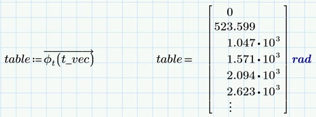

There is an undocumented trick to turn a range into a vector by following the assignment with an inline evaluation:
t_vec is now a legitimate vector, not a range (unfortunately ranges and vectors look the very same in Prime).

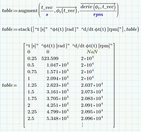

A more "legal" way to create that very same vector is seen here:
Now you can use this vector to create a table for later use - don't forget about vectorization (the arrow over the expression)
or create a more comprehensive table
But of course you still can't evaluate the functions and their derivatives symbolically as you tried to do because the functions derived by OdeSolve are numeric only.
