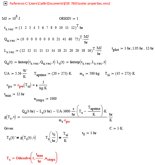

Hey guys,

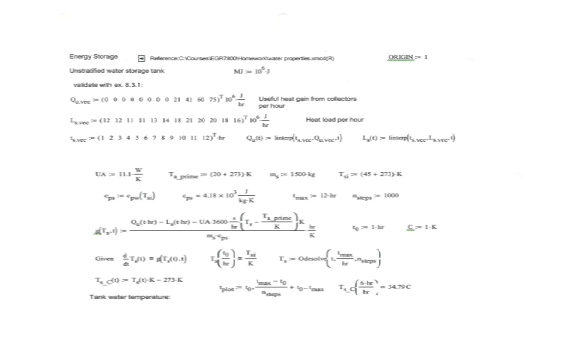

I am a grad student that is brand new to mathcad.  I've tried looking at other solutions, but unfortunately, I just can not find what I am doing wrong.  I am looking at an example problem that was  done in class and am trying to recreate it (a pic is attached).  As far as I can tell, I have exactly the same program this far (my sheet is attached), but mine gives an error of "this variable is undefined." If someone could check it over and point out what I am doing wrong, I would really appreciate it!
Caitlin
Werner_EAnswer
The problem is the prime symbol, which you have placed at the wrong position (after the argument parentheses). If you look at your expression closely, you may see a small multiplication sign, so Mathcad is multiplying the function outcome T.s(t) with the prime symbol which will not work.
You have to place the prime symbol right after the function name (before the argument parentheses). As you function name uses a literal index, the prime symbol will show up subscripted, too, which looks rather ugly

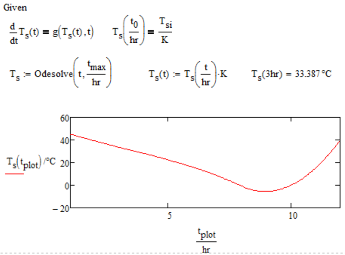

So probably its better to use the full differentiation operator as was done in the original work which you had posted a (very poor quality) picture of
You probably know that you must use the symbol from the calculus tools palette and are not allowed to just type a normal fraction.
Werner

Hi Caitlin,
Unfortunately, the picture appears to show the correctly working program, so I can't tell much from it.   However, I can't tell anything from your worksheet either, because it references another worksheet "C:\Users\Caitlin\Documents\EGR 7800\water properties.xmcd", which  I'm guessing this worksheet defines the function cpw?    So what I see is this:
Any chance you could post the water properties.xmcd worksheet, please? (It might be worth opening the worksheet to check that it doesn't have any dependencies itself).

Sorry, your data at what pressure?
Werner_E25-Diamond IAnswer
Werner
@Stuart: The referenced file is not absolutely necessary, as we can assign the variable c.ps any reasonable value - I used the 4180 J/(kg K) from the picture even though the values of UA and m.s were chosen different from the pic by Caitlin.
