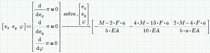

How can I find symbolically the ex,ey and Phi variables? I have tried with solve block, but the solution was the guess value.
See the 3 equations in the attachment
Thanks in advance!
RichardJAnswer
Like so

This is a static problem, to find the S1-S4 reaction forces of the statically indeterminate structure with energy method.

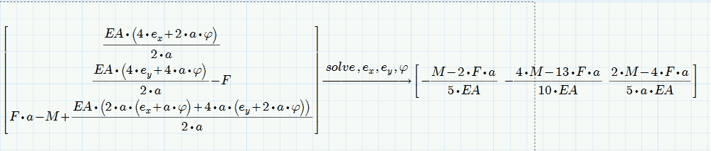

If you write equations to solve you have to use the boolean equal sign.
If you use the solve block you will not only have to provide guess values for the variables you want to solve for but must provide values for all variables used.
In Prime (in contrary to Mathcad) a solve block ist only to be evaluated numerically.
What should the three pi's represent?
constants? Then you just have two equations.
functions? Then you have no equation at all

The tree Pi represents the inner, outer and total energy, and it is the force times the distance the object is moved

I got confused because you defined your functions kappa like variables (which works because you use the symbolics) and so guessed wrong as of the equations you want to solve.
Fortunately Richard was around and guesewd right.
You can also use the derivatives in the solve statement:
A numeric solve block should work, too. But here you would have to define your functions correctly as functions (kappa(ex,ey,phi):=....) and provide values for all constants as well.
