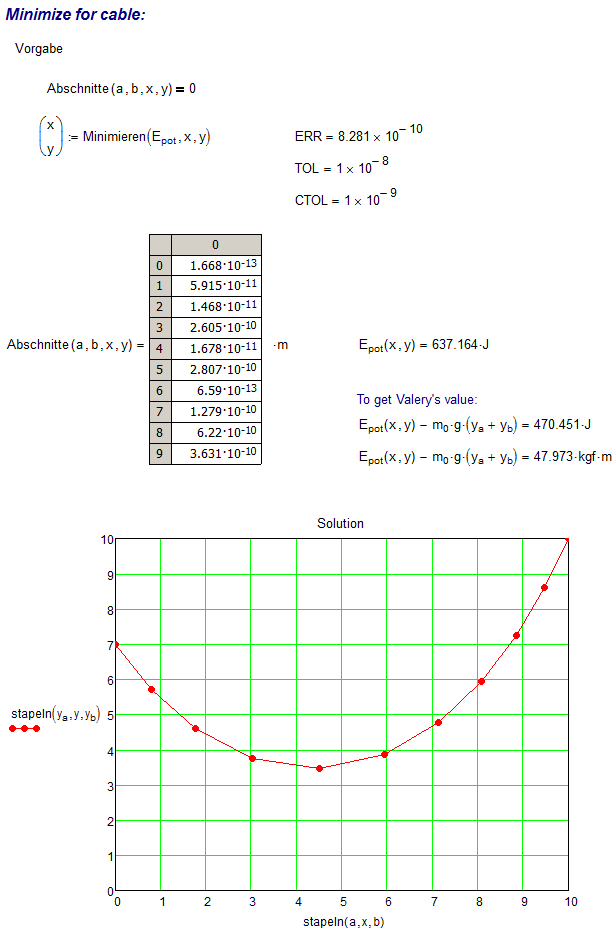

Hi Valery
It works in Mathcad 15, too:
The details you will find in the attached files.
Regards
Ueli

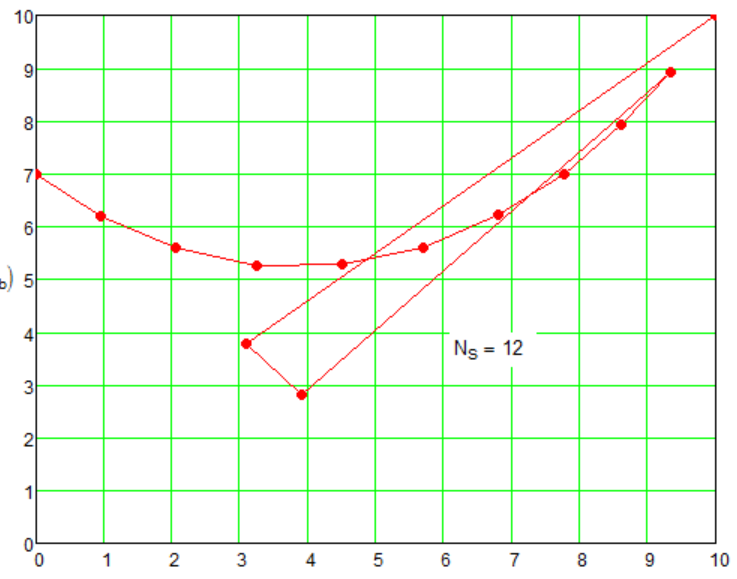

Ich bedanke mich herzlich, Aare, fuer Ihre Lousung!
But I was waiting for the solution with different Ns

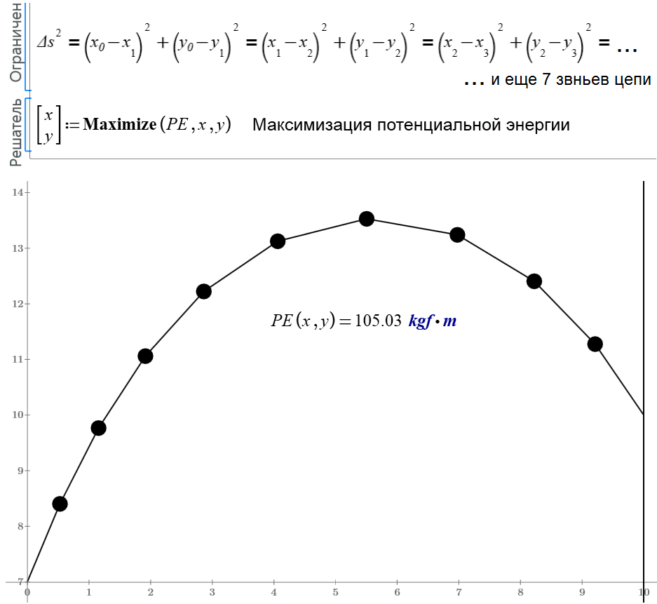

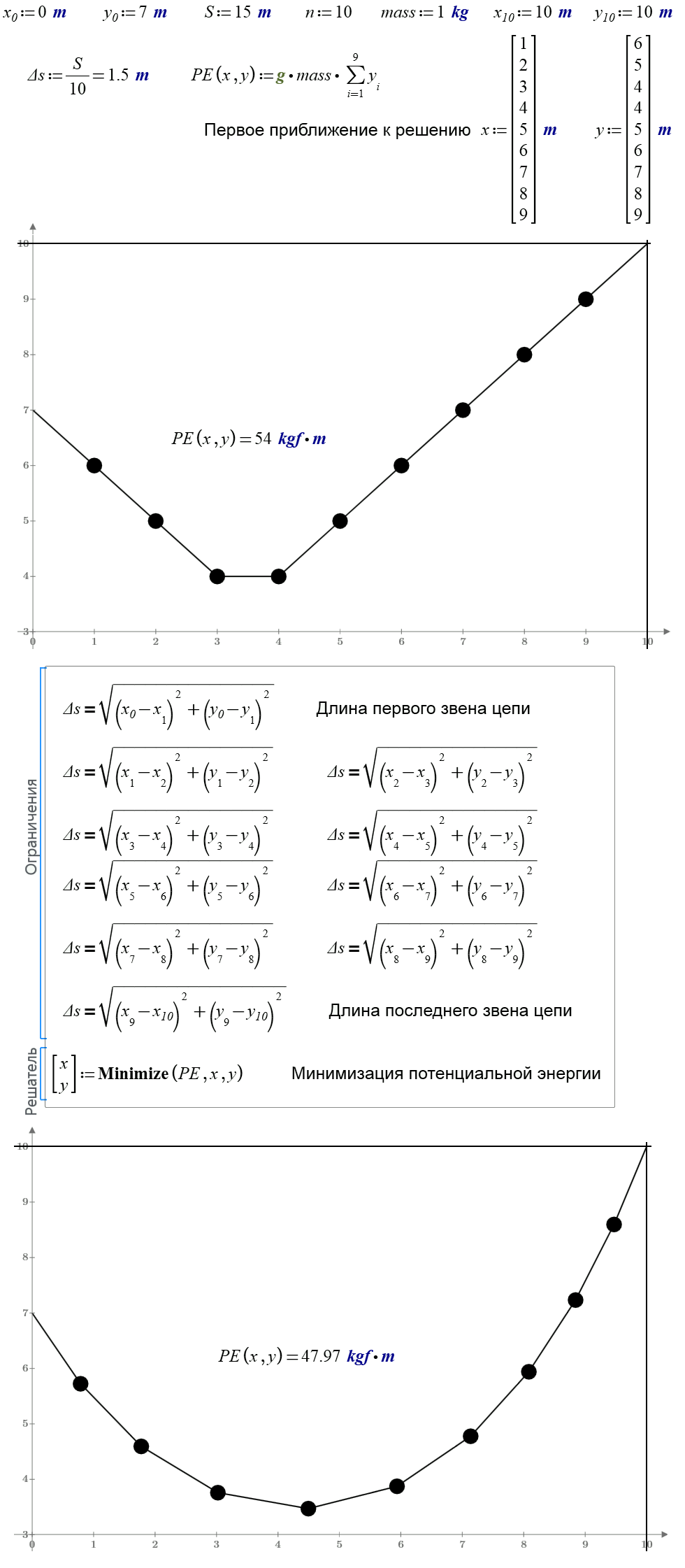

Продолжение темы - Continue
Solver Mathcad 15 and Mathcad Prime

The article
CAUTION: CATENARY WITH POTENTIAL ENERGY!
