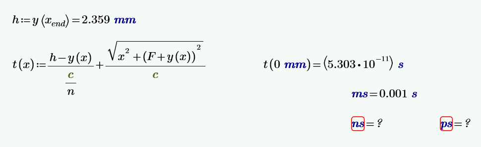

I would like to use in my Prime-sheet time units ns (nano-) or ps (pico-) from the list of built-in units but:
Is it a bug?
LucMeekesAnswer

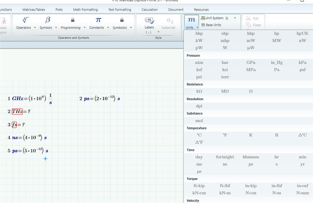

September 25, 2016
No problem here with Prime 3.0.
I can type the units manually or chose them from the Units menu - they always work as expected.

September 25, 2016
In my Prime 3.1 express  the 'ps' works, and can be chosen from the units menu.

Open please the attached Prime 3.1 sheet with undefined ns and ps
When I open new sheet - all is ok with ns and ps.
When I open attached sheet - problems with ns and ps.
LucMeekes23-Emerald VAnswer

Found it.
The unit system is set to CGS. If you set it to SI, ps and ns are defined
