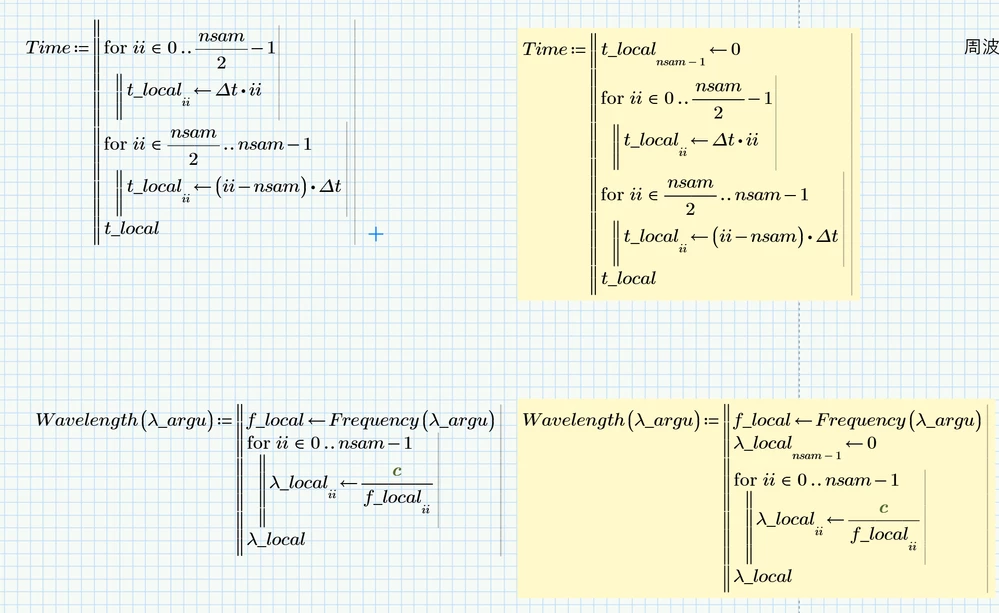

To speed up the calculation
The same program takes longer in mathcad prime10 than mathcad14.
This program uses arrays in particular.
So I got the following information:
"The most efficient way to use computer memory when using matrices is to pre-allocate the matrix. To do this, assign 0 to the last element of the matrix. This ensures that there is enough memory for the remaining elements of the matrix. If you dynamically allocate a matrix by filling in the elements of the matrix from the smallest subscript to the largest subscript, it will take longer to calculate and the worksheet will calculate slower."
But I don't know how to improve it.
Can someone please help me?

You initialize the arrays by setting the element with estimated or known last index/indices to zero before assigning any values to the array.   This minimizes the time Mathcad spends adding new elements to a dynamic array.   For most purposes it makes little difference.  However, it can give some time savings for large arrays.   This was more of a problem with early versions of Mathcad running on the much slower PCs of the era.
Here are a couple of examples from your worksheet:

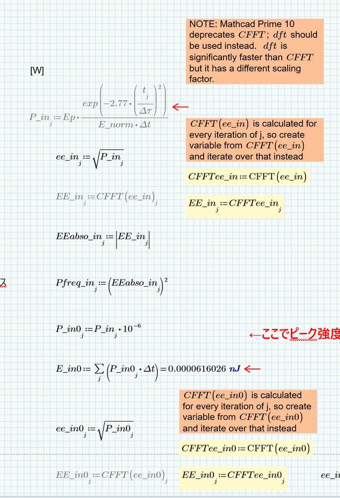

Some other small savings may be made by precalculating some of Fourier Transforms.  When indexing CFFT(ee_in)j, for example, Mathcad will evaluate CFFT for each j.
Also note that CFFT is deprecated in Mathcad Prime 10, and it is recommended that it is replaced with dft.
"The new dft/idft functions replace the functionality of the deprecated cfft/icfft and CFFT/ICFFT functions and offer significant performance improvement, particularly for larger data sets and cases where the size is not a power of 2."
"Functions dft/idft differ from the deprecated fft/ifft, FFT/IFFT and cfft/icfft, CFFT/ICFFT in both the scaling factor and the exponent sign." - the scaling factor is now 1 for dft.
I hope that gives you a starting point for improving the worksheet's performance.
Stuart

I've made a few changes in an attempt to improve performance (eg, replace CFFT/ICFFT by dft/idft, replace some loops with vectorization, and take constant term calculations outside of loops).  Sadly, they do nothing to make the main function run faster.
I haven't changed the dft/idft scaling, so the results aren't the same as the CFTT/ICFFT results; I was only interested in seeing if the changes improved performance not the accuracy of the results.
Note that I've significantly lowered the values of nsam and RT when testing the main function - I generally like to see the result in a few seconds rather than many minutes!
I suggest putting timing points within the main function loop to profile the function and see where any bottlenecks occur.
Stuart
