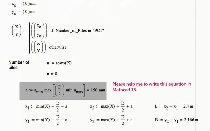

Dear Friends,
Please help me to write an equation, which is attached.
MJGAnswer

In my opinion, these two alternatives are more clear than the equation in your image (values for a.min, a.max, and D are assumed):

December 16, 2015
It would help if you showed us the values of each variable.
To me, it looks like they used an infix operator.  In my opinion, this just makes it confusing.
Select "Infix Operator" from the "Evaluation" toolbar (View -> Toolbars -> Evaluation).
Three placeholders will appear.  Type the first variable in the first placeholder, the function (min or max) in the second placeholder, and the second variable in the third placeholder.
Example:
gbayazid1-VisitorAuthor
December 16, 2015
Thank you Mark Gase.
