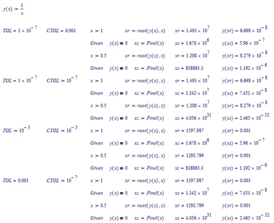

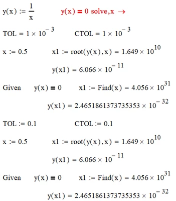

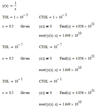

December 16, 2019
In Mathcad 11? But in Mathcad 15 and Prime. Send please your Mathcad 11 sheet!
December 16, 2019
Worksheet is attached to my first answer.
What does it give in Mathcad 15?
