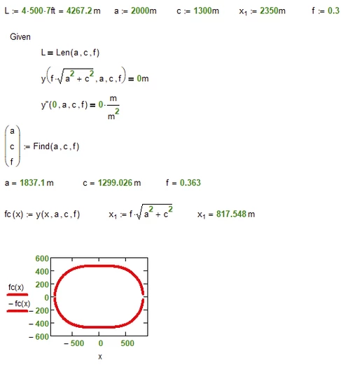

January 31, 2021
How about adding a scaling factor?

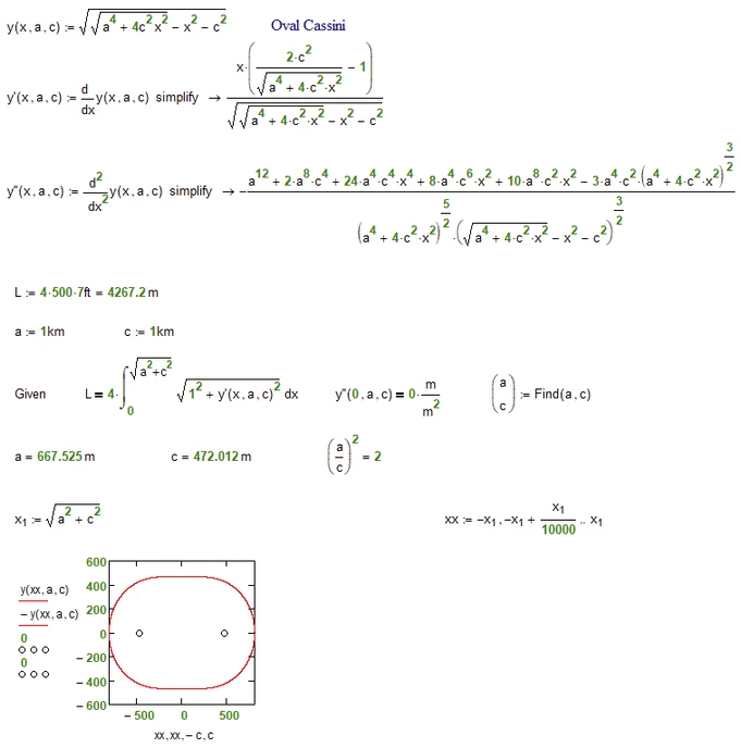

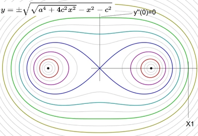

New math constant?
a/c=1.4142...
c/a=0.70711...
January 31, 2021
@ValeryOchkov wrote:
New math constant?
a/c=1.4142...
c/a=0.70711...
No, not new. Just sqrt(2) 🙂
y''(0)=0 is equivalent with a = c* sqrt(2)
You could use this right from the start in your equation.
January 31, 2021
Sorry, the addition of the scaling factor was rather nonsense. Scaling the parameters a and c do the same job, so f is not necessary at all. I guess that getting rid of your variable x1 did the job.
So a shorter solution is this:

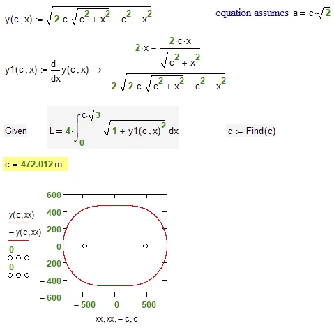

January 31, 2021

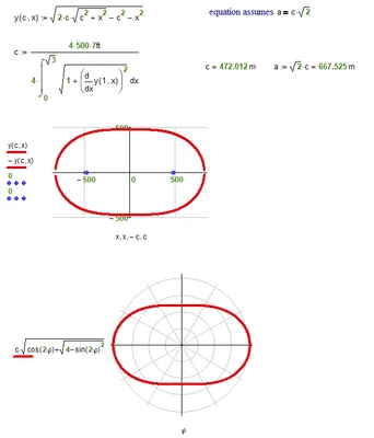

And here is an even shorter approach which uses, that for the curve you are looking for we have a=c*sqrt(2)
January 31, 2021
This seems to be so far the shortest solution.
Using no symbolic and no solve block
