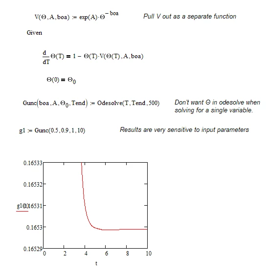

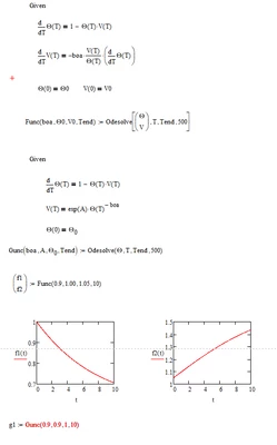

I have 2 ode's that I solve using odesolve. However, I can integrate one of them analytically. When I do this, I get the error message "Too many initial conditions" even though I only have one for the remaining ode. Or can I
not include the integrated function in the solve block?
Mar 17, 2023 11:46 AM UTC
See below

Mar 17, 2023 1:49 PM UTC
THanks.
Sensitivity to inputs: Yes, that is the nature of the equations. Especially sensitive to boa.
