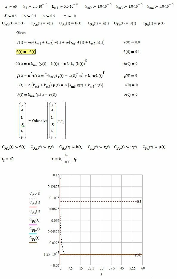

Mathcad is right. You have too many initial conditions, as also you have too many functions to solve for.
The set of differential equation does not provide enough equations to solve for 6 functions, only 5.
So you can solve for 5 functions, e.g. by assuming that C.Ab(t):=0.1 (all the time) which is what I did in the attached sheet. I did not find a clue in the article regarding how C.Ab(t) was handled.
I hope you can find it.

November 25, 2019
If I knew, for example  the diff. eq, f' (t)=f(t), there would be no problems, see image:
