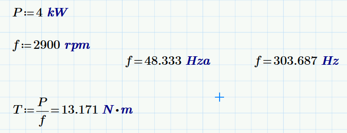

Can someone tell me how is this possible ? I gues it has something to do with rpm unit. Can i somehow redefine this unit to work correctly ?

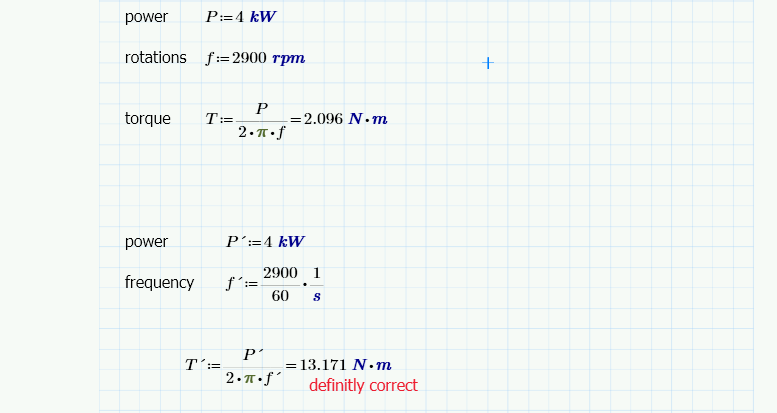

Thomas,
use the dimension like applied in attachement, and all will be fine.
regards
Volker

rpm is in angular frequency (60 rpm = 1 Hza)  (1Hza = 6.28 Hz)
Try speed in rpm and torque in N m, get power (correctly.)

Thomas,
regards
Volker
