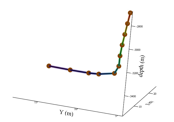

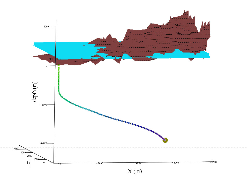

Something similar we previously helped solve...
We wrote a short Mathcad program to create a function to convert an array (from Excel) of real world coordinates to Cartesian form
Mathcad 3D plot to help visualise the drill path
I assume you want to add ellipses along the drill path which are correctly oriented.

- and the worst one Is it possible to create a overall mesh or solid imag?instead of the ellipses? See the image attached (as a gross example)

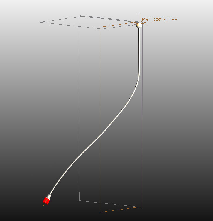

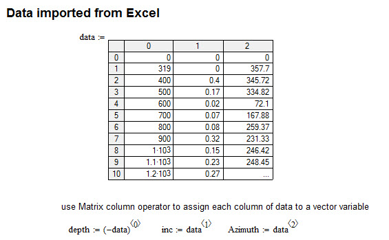

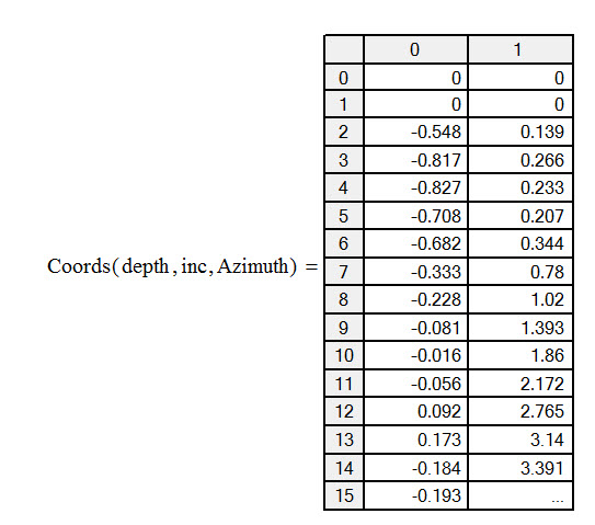

Without actually calculating the required data arrays to recreate the shape features you require, this was my best effort with Mathcad...
My thoughts are that, whilst adding the detail (ellipses) along the drill path should be possible in a 3D plot.
It may be easier/more appropriate to use tools better fit for simplifying such tasks.

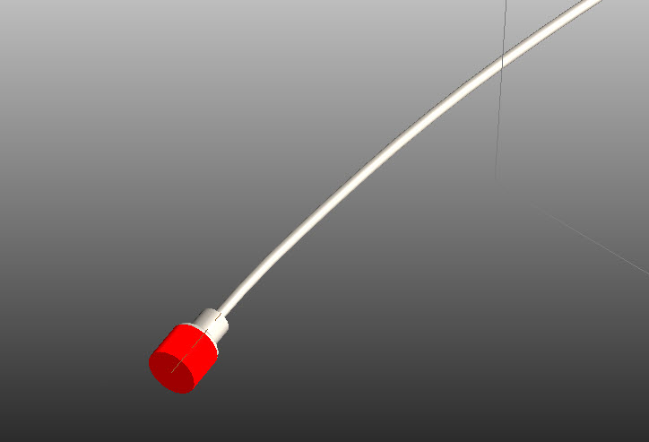

In this case, because Mathcad arrays can be directly imported into PTC Creo Parametric.
In the example above the data (x,y,z) array from Mathcad is used to define a curve in Creo parametric and reconstruct the drill path.
It simple to then build specific geometry along the curve that represents the drill path.
With the data linked to model, it should be possible to quickly update the view with new drill data.
Here is the attached Mathcad file.
This can be done with both Mathcad 15 or Prime 2.0 and Creo Parametric 2.0.
