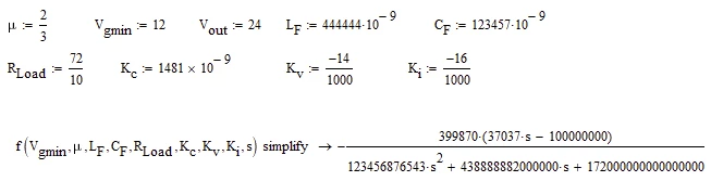

I have a discrepancy in the results of the 2 transfer functions.
The implementations in Mathcad and Matlab are identical, so normally I should have the same result.

What could be the reason why the 2 results would not be equal?

Try using integer values throughout to avoid the symbolic fall into float mode (where it obviously can't cancel expressions).

I would do this: I define the complex pulsation s as user 1 as well as x in the program. Then I reset all the variables:
