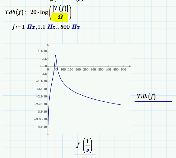

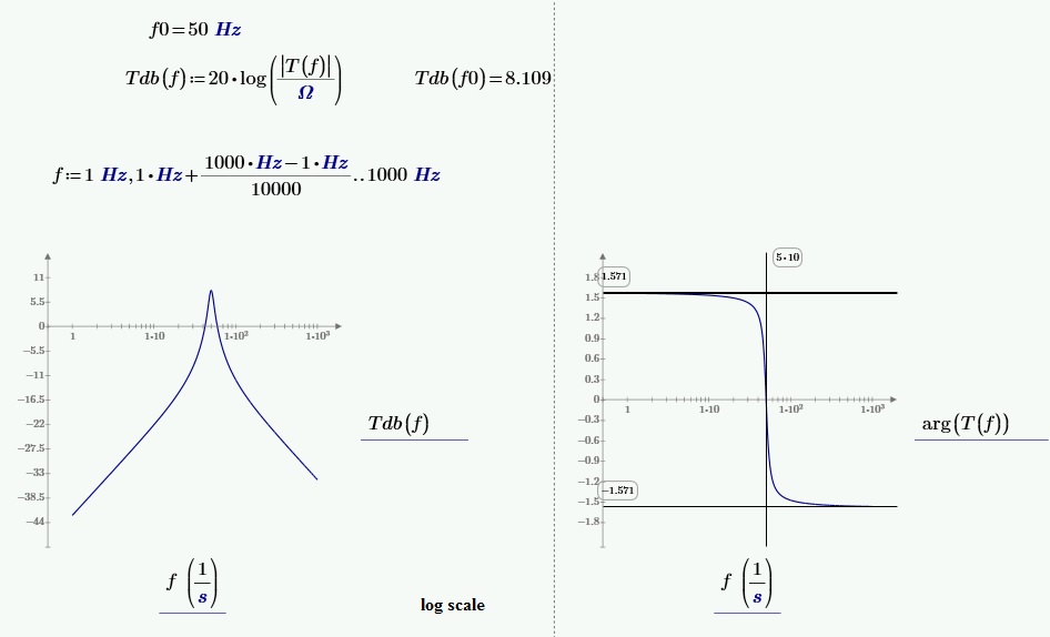

Just got hold on an 3.1 installation.
The reason why your plot fails is because T(f) has unit Ohm but to be able to take the log of it, it has to be dimensionless.

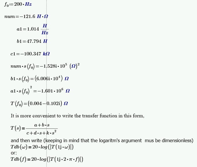

June 20, 2016
The quality factor must be dimensionless, and the bandwidth must be in Hz or, but more rare, in radians / seconds as well.
