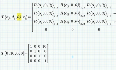

in this worksheet prime does not want to calculate
anyone have an idea, the function is however defined

For the argument in the function T( ) you used "theta" with a literal index "j", but the defining expression on the RHS uses "thetaj" without index.
If you change this either way, it works as expected:

I'm ashamed, probably a moment of weakness sorry
thanks Werner
