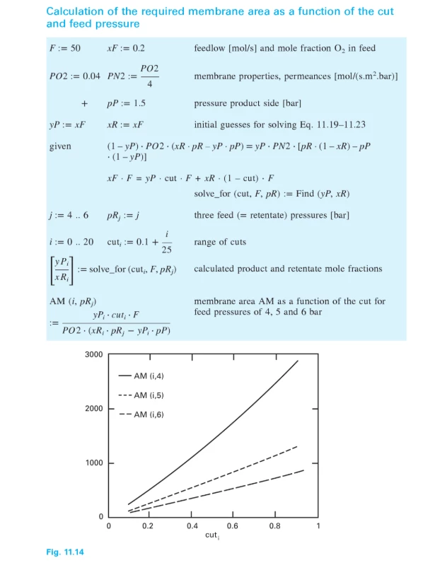

I am trying to complete an assignment however I have difficulties translating a Mathcad code from the book to the worksheet, I have never used Mathcad before so it would be great if someone can show where I am going wrong or even better if someone can translate it onto a Mathcad file for me!

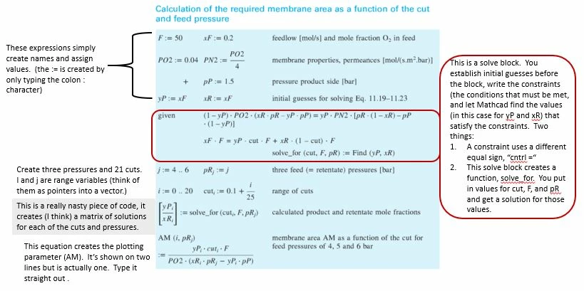

See attached  (but next time attach your own worksheet attempt, even if it contains errors - it is generally easier for us to modify an existing attempt than to construct a worksheet from scratch).
Alan
NB You didn't say what version of Mathcad you are using.  The attached is Mathcad 15.
