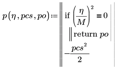

Hello, can anyone help me write this in mathcad prime? Can't seem to place "otherwise" in my equation

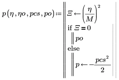

Use an "else" instead of "otherwise".
It would look like this:
Some remarks:
  • You may omit Xi and use the calculated expression directly in the comparison
  • function argument etao is neverused, so it could be omitted
  • the assignment to a local(!) variable p in the last line is not necessary and useless

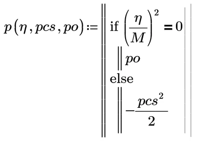

So it could also be written as
And if you like you may also use the if-function instead
And because program execution exits after a "return" statement, you may also write
