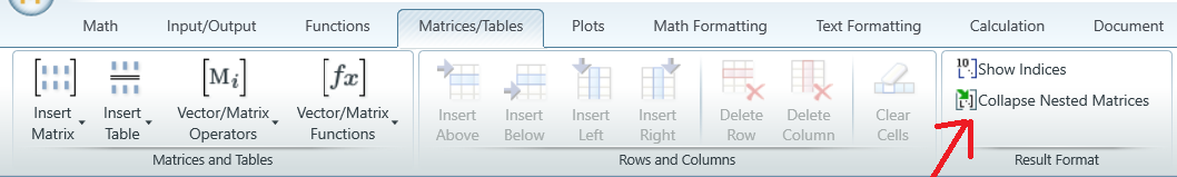

To see the values of the matrix elements, In the "Matrix / tables" menu, click on the button placed on the right, to expand nested arrays.

And you can show the entire expanded vector by selecting the the vector and using this option:
