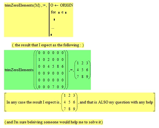

Feb 27, 2024 12:41 AM UTC
I appreciate for your answer with .xmcd, mathcad file, Werner. 😊 ( I usually type a wrong key-stroke ! ) and :
and of course I would expect is :
                                                           1''.PNG  !!
   In any case of INPUT and the OUTPUT is as the my question above ( yellow highlight )
       Best Regards.
            Loi.

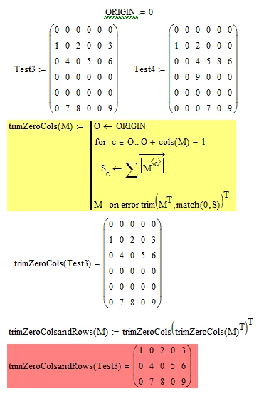

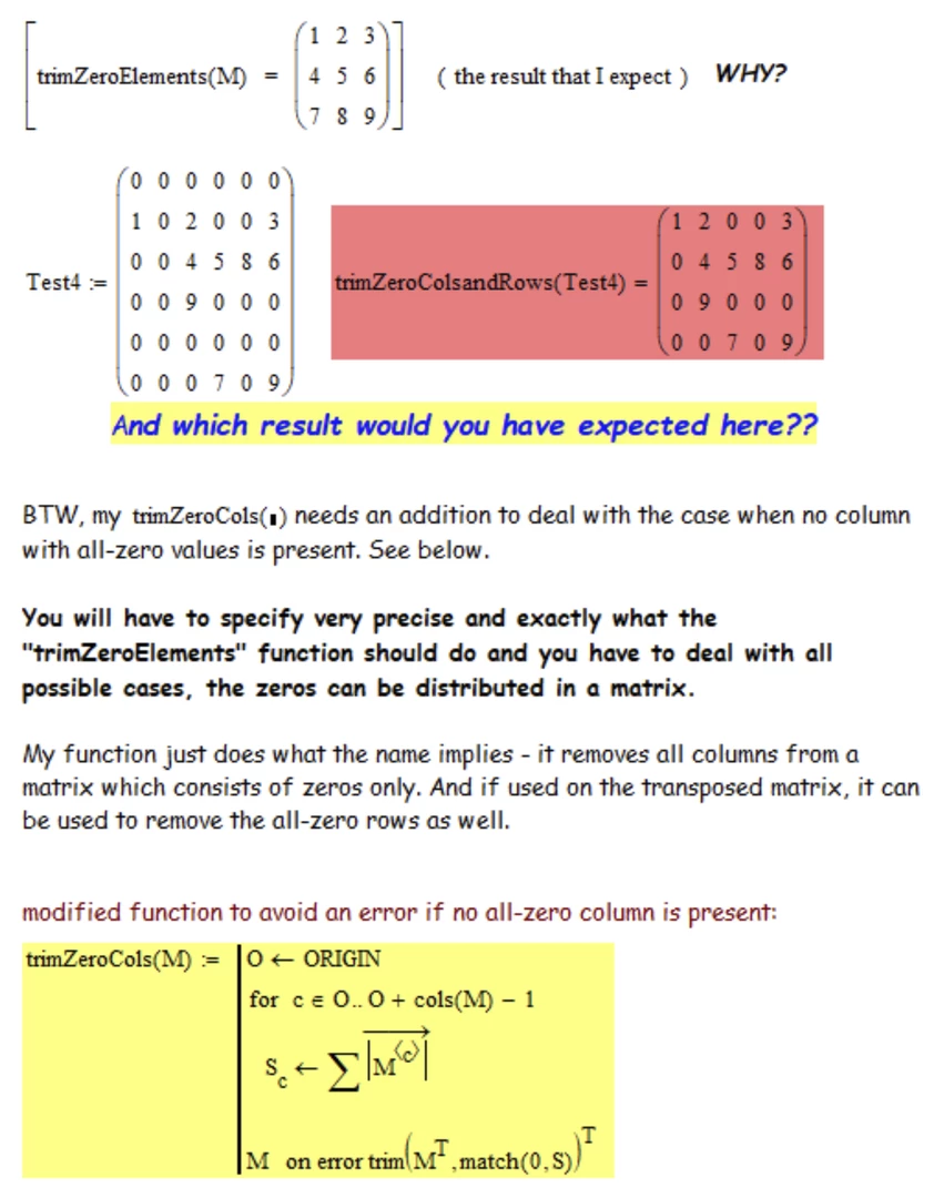

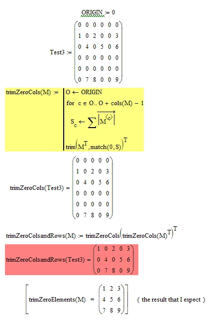

Feb 27, 2024 1:57 AM UTC
Really? The "3" is coming out of thin air. Its not in the input but appears in the output?
I can see no logic here! Why would the numbers be rearranged that way? Why does he "9" appear only once in the result? .....
And what would the desired output be here? 25 zeros and 11 non-zero numbers, all different.
You will have to clearly and precisely DESCRIBE what the behaviour of your magic function should be - not just providing one or two examples!

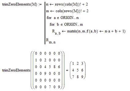

Otherwise I would, from what you posted so far, suggest the following function
