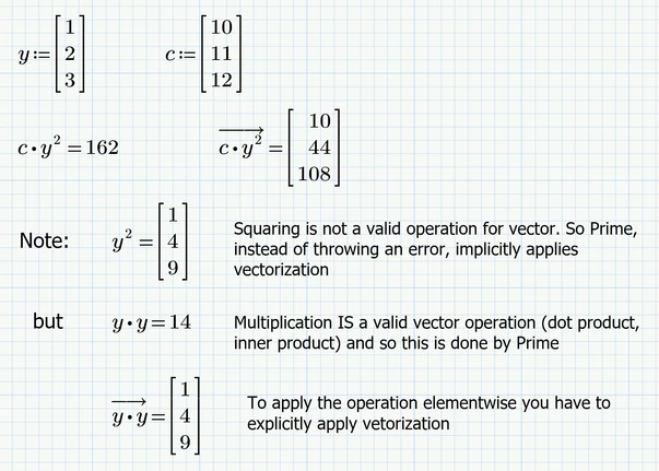

I can't open your worksheet with my Prime 6 but I guess you want to now about and should use vectorization.
If c is a vector and either ri or y (or both) is a vector, too, then you are multiplying vector c with another vector and Prime of course uses the vector dot product and the result is a scalar. If you vectorize the expression, you should get a vector as result.
A good rule of thumb is - if you want an operation to be done element wise, don't rely on Primes implicit vectorization but rather apply vectorization explicitly.

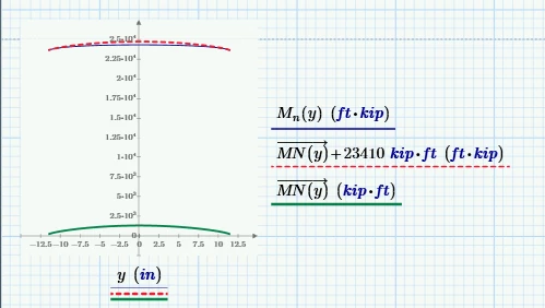

August 5, 2022
As mentioned, Mathcad wants to do a dot product between two vectors:
You can write your moment function to solve for a single value of y (renamed z), you must also adjust for the value of c:
When you do that, you can see the error the dot product creates:
And what the actual function should be:
