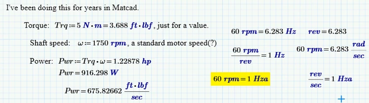

Do you mean you don't see the results shown in the pic below when you type in these expressions?
Be ware that rpm is defined in Mathcad as   2* pi rad / (60 s)
and revolution (rev) is defined as 2pi (or 2 pi rad), not as 1.

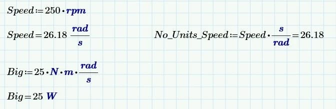

Mathcad (even Prime) does an excellent job of managing units.  Including unit conversions.
The Mathcad unit "rpm" has 2 pi built in so that it will handle angular speed correctly.  Note that the companion unit "Hza" has that too!
Prime 4 (Express) file attached, should open and execute in 7.
