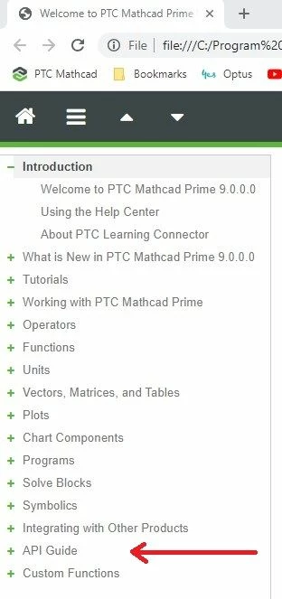

Some examples for the use of the Prime API are found in the API Guide in help. But I am sure you know that, so pictures below are for the benefit of others
The API Guide has a number of examples but not one for VBA - Excel.
From the guide
Object: Application
The Application object is the only object that you must create (using new). You retrieve all other objects by assigning interfaces.
Refer to the following examples:
•Managed code: VB, C#, and C++ using ApplicationCreator
•Scripting code: JavaScript and VBScript using ActiveX, an Application object.
VBA - Excel is not managed code so needs an Application object.
From the VB-Script example in the API Guide.
From the guide
Object: Application
