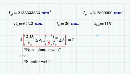

What I can use between both of these conditions inside the ( if function) as shown in the below picture and the attached file?
or how I can use 2 conditions at the same time (by or & and command ) as per the excel sheet.

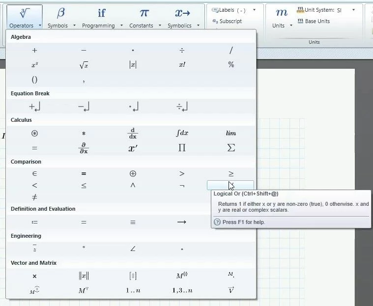

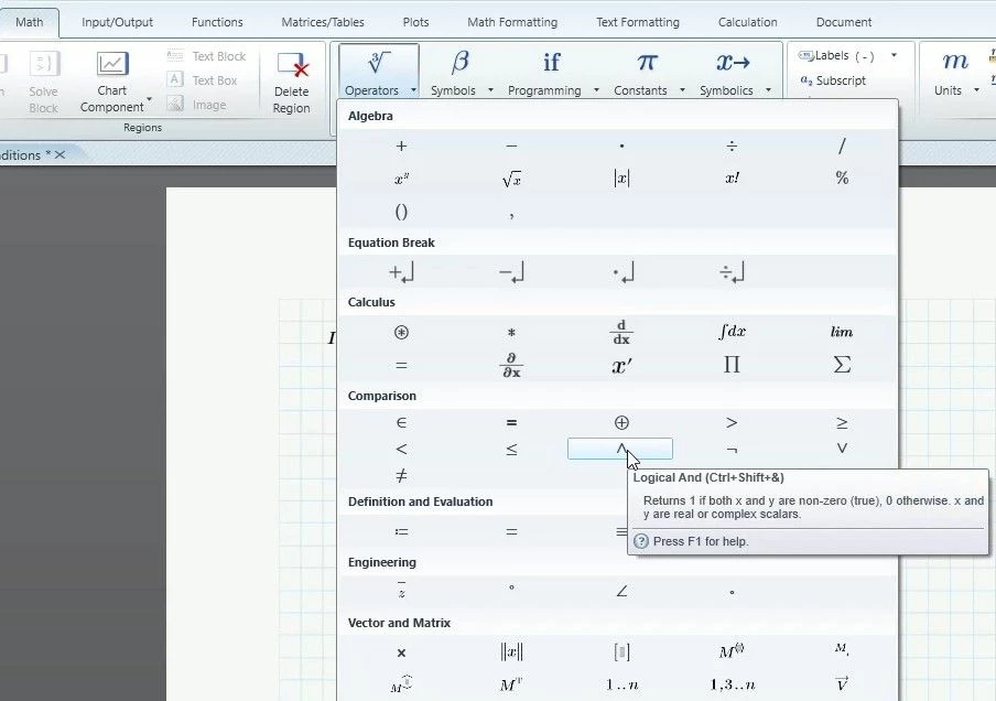

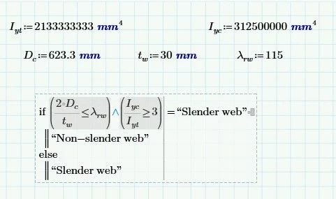

Using Math | Operators & Symbols | Operators | Comparison there are And and Or
