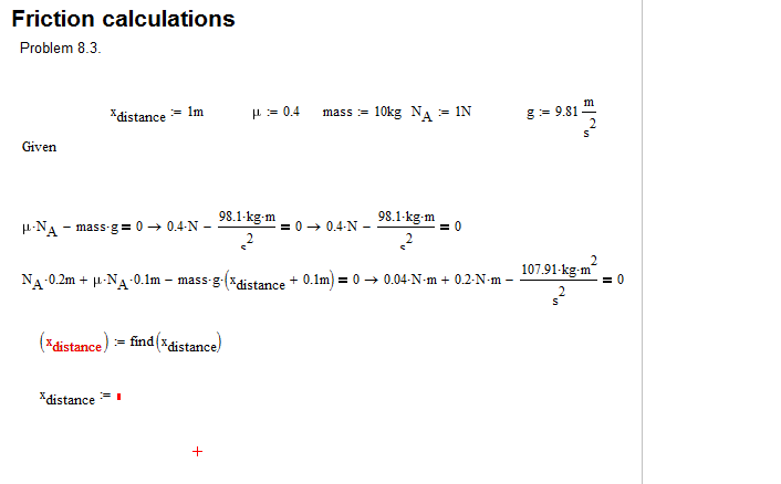

Hi Guys, previously you help me so I have hope that you will explain me where is problem here:
First of all I trying to find x value is in Meters. Of course i don't care about the value of mass and Na because it will reduce during the solving.
I don't know why I have x.distance as undefined? And why can't get the result that should be : 0.5 m

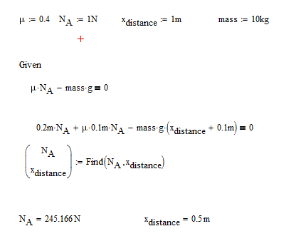

Like so:
You are only solving for two parameters.  mass is just there to keep the units consistent; you could replace its magnitude by virtually any value.
With two unknowns you must solve for both.  You need a 2x1 vector to which to assign the results as they have different units.
Alan

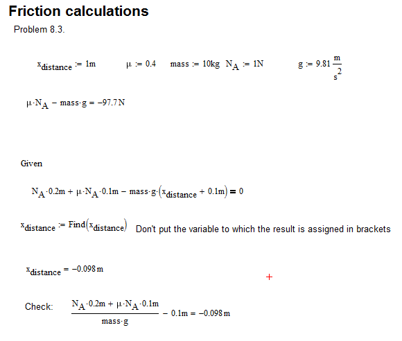

You don't really need a solve block here, but if you insist, then:
I've assumed NA and mass are fixed.  If NA is an unknown variable as well then you need to solve for both NA and xdistance together even if you are ultimately interested only in xdistance.  If both NA and mass are also unknowns then not only do you need to solve for all three together you need to supply a third equation.

1. I don't put the variable in brackets it was, a matrix not a bracket I just learned here that matrix don't care about the units. So why it was a problem?
There is no information about NA and mass there are not fixed. And in reality you don't need the 3eq because based on those 2eq you will see that distance x don't depend on value of mass and g. So how to solved with 2 equations?
Because answer is X=0.5m

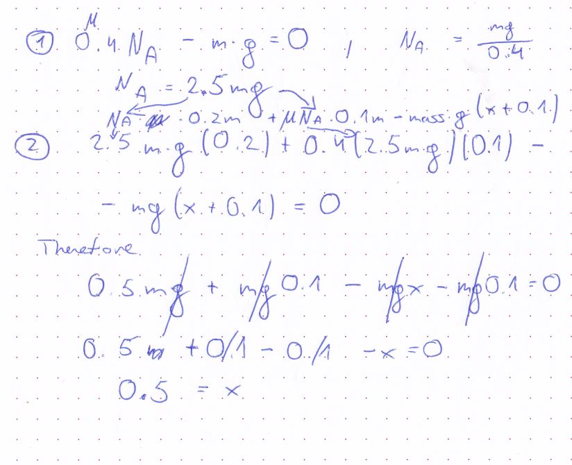

Thats how i solved by hand:
So it's easily seen that it will reduce the m and g during the calculation. How to implement those things in Mathcad?

Like so:
Alan
lnadolny1-VisitorAuthor
September 25, 2015
Thank you but what i have wrong in my Mathcad? That I received 1N and 1m  (I correct the subsricpt a to capital letter for variable Na.)
