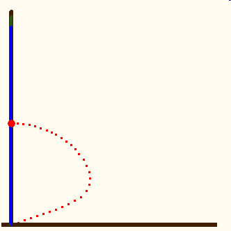

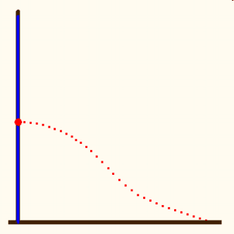

Any idea what family of curves we are seeing here?
Of course there is a difference depending on which side the longer plank is (click the image to animate):

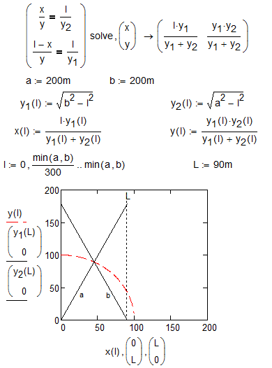

Jun 26, 2014 4:20 AM UTC
It is some Mathcad-card-game
Now we can "showing our cards" (to bluff).
My solution:
And what are your "cards"?

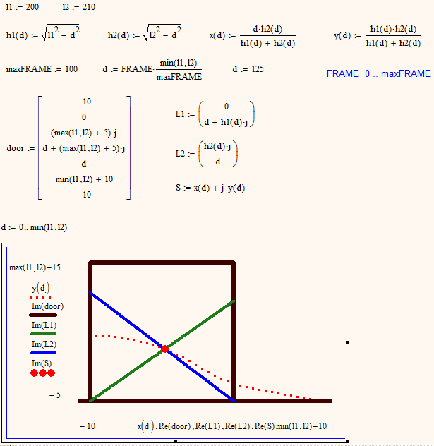

Jun 26, 2014 7:53 AM UTC
No, it sure isn't a game at all, but if you really are interested, here is a screenshot of how I did it. Nevertheless thats the trivial part of the task. The interesting part is to find a closed form of the curve equation or at least be able to determine the class of curves it belongs to. I have no solution to this part so far.
