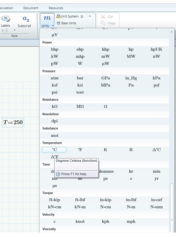

You just type T = 250 then enter the unit, ° C. You're wrong if you write 250, multiplied by ° C.

August 23, 2016
  • type 50
  • press ALT followed by M and U
  • select ° using mouse (or press several time DOWN ARROW)
  • press ESC twice
  • type C
  • type =
  • press ENTER

August 23, 2016
This one works really well too and could be really useful for other commands. Thanks.

So it seems there are a few ways to do it. None are as simple as i hoped, but I like the solution from Magnus the best.
Thanks!
August 23, 2016
I agree that the method Magnus suggests is the best so far. Its even more convenient on my German Keyboard as we have a Degree symbol available directly.
Unfortunately the method only works when the variable is defined T:=50° and not when its displayed via T= and we have to replace K by °C. Martins more cumbersome way works here too and we can take the degree symbol from the angle unit at the top of the units list (but not from my keyboard). Not sure what the two times "Esc" do but it works. Depending on the situation copy and paste might be easier.
