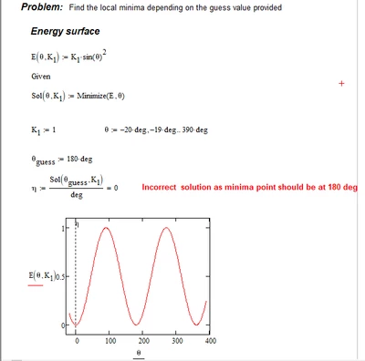

I am trying to optimize the solution of minimization function depending on the intial guess values. Surprisingly, my solutions are independent of initial guess values even though the function has several local minima. I am attaching the Mathcad 15 worksheet for the refrence. Any help will be highly appreciated!

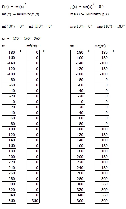

The guess value can influence the outcome of "minimize", but its not always obvious which guess results in which minimum.
Furthermore I have no clue why the vertical displacement (a very tiny one is all thats needed) shown in function g(x) makes that big a difference for the outcome of minimize.

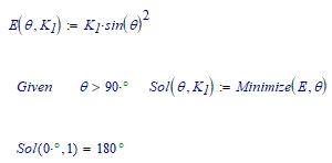

Apparently Minimize doesn't require a guess value...
You may need an extra constraint to force Minimize to find another than the first minimum:
Alright! However, what is the way to dynamically optimize the constraint. This is beacuse I would like to find the local minima as a function of theta (region of interest). For example if theta is less than 90 deg the solution should be 0 deg, for theta between 90 deg and 270 deg, solution should be 90 deg and so on. Please not that in this case the constrains are very well discretized but in general it may not be.
