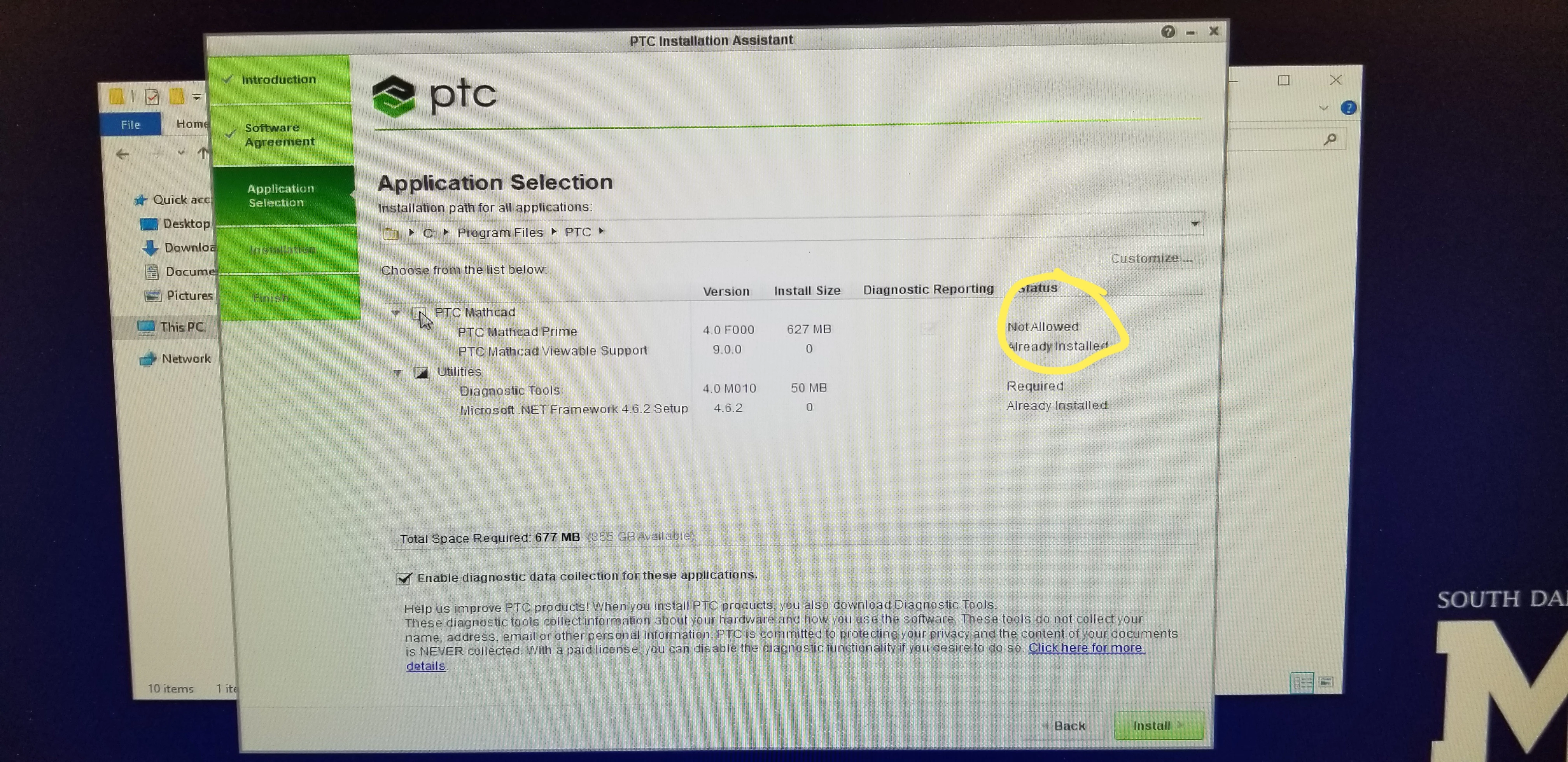

Our technology people accidentally installed Mathcad Prime 5.0 on a classroom computer instead of 4.0.
When they addressed their mistake they found they could not install 4.0 and a cryptic error message with no detail was given.  (See screenshot attached).
They were able to uninstall Mathcad 5 (though I have both on my laptop with this.
Please advise.. I need that console working with Prime 4 in class.
Cheers and Thanks Much!

1. Go to Control Panel -> Program and Features and check that Mathcad Prime 5.0.0.0 and 4.0 are not installed. If they are - uninstall them. The natural order is to first uninstall 5.0.0.0 and 4.0 after that.
2. If you want to be on the safe side you may delete, or rename the installation directories that by default are under c:\Program Files\PTC.
3. Now you should be able to install Mathcad Prime 4.0.
If it does not solve the problem - contact technical support.
"Viewable support" is unrelated. No need to uninstall it.
Keeping license file is a good idea, but it is not needed to install the application. Installer does not check license and allows to install even if you do not have license at all.
It is possible to install several versions of Mathcad Prime on one computer, but it should be done in ascending order. (For example - 4 and after that - 5).
