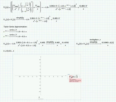

Hi @LucMeekes
I tried transforming the input signal Vi(s) alone to Vi(t). But it is showing error in plotting. I don't understand why while taking inverse laplace transform, "s" term is coming. And what does this delta(t) mean? Can you please correct me where I am wrong?

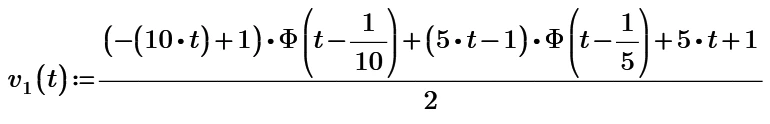

I guess essentially I was asking: How did you come to the expression for the Laplace transform of your input signal?
Since it is not common to have/know only the Laplace transform. All in all this is assuming you're dealing with a real-world problem, and not some pure theoretic set-up.
The reason I'm asking is because that Vi(s) contains expression parts that are quite uncommon for the Laplace domain: the (1-exp(-a*s)) occur in signals with a step and staircase shapes.
Seems like your input signal is the double convolution of a box and a staircase.

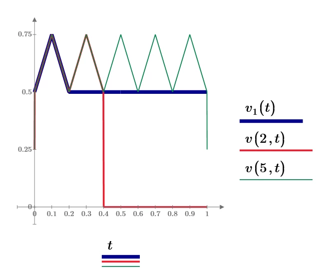

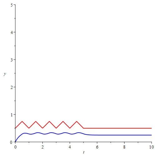

ttokoro
Maybe input signal is infinity number of triangle waves shown in green plot but that only shows 5 waves.
But cannot get Vout(t).
t.t.
Hi @ttokoro this is right. The input signal is a triangular wave. May I kindly know why you are saying that Vout will not be obtained.
ttokoro

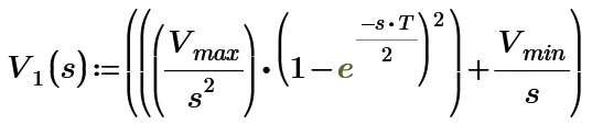

The Laplace transform of a repetitive waveform with a period of T is
where, V1 (s) is the Laplace transform of a one-period waveform.
Unfortunately, it cannot inverse transform to t domain waveform. Therefore, we must use finite number of Laplace transform of voltage waveform.

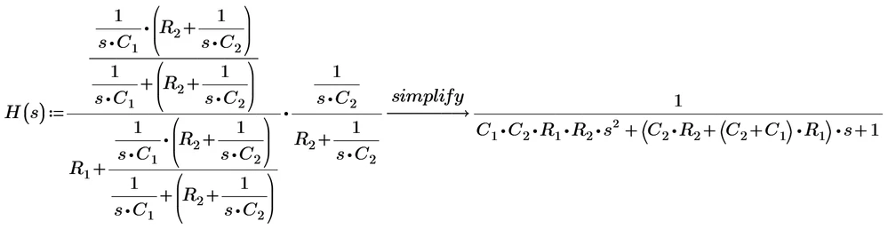

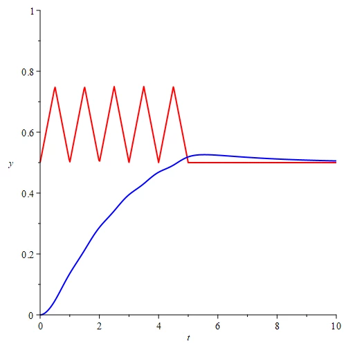

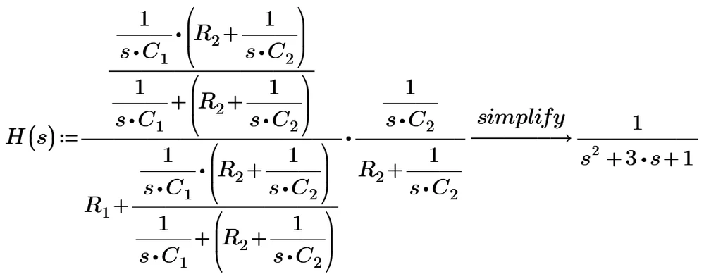

Left plot shows the transient current response of RL Circuit. (R=1, L=1)
Right plot shows RCRC circuit response of all is unit value.
In this case Mathcad can solve the answer. (In these plots, I use Maple2022 because it is faster than Mathcad.)
But using your R and C values, it shows nothing because C and R are so small and immediately charged to the applied voltage.
I think the time constant is so small and numerical calculation is failed.
