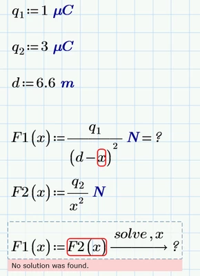

Hello, I need to compare two functions F1 and F2 to get get the variable x, but im new and having trouble with it. Could someone help me. Thank you

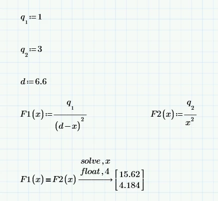

Here's a tip:

But it doesn't let me put an equal sign between F1(x) and F2(x), saying that x is undefined

September 13, 2021
You need to use the boolean operator "Equal".
