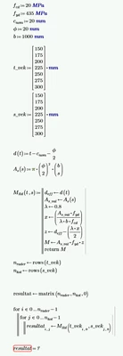

Hi!
First of all... I'm kind of a n00b in Mathcad so please bear with me.
I am writing a sheet thats supposed to calculate resisting moment in concrete slab using vectors and matrices and some code blocks. Or I didn't write it... Google AI studio did 😕
As you can see in the attached image and the attached file I', getting "Undefined variable" when trying to visualize the matrix, wich accoring to Google should work. Further down it will result in i a table the for export to Excel.
As I'm pretty lost, and Google cant fix it (neither do ChatGPT) can you spot the error(s) 😉
I'm using Mathcad Prime 10.0.1.0
Best regards,
Fredrik

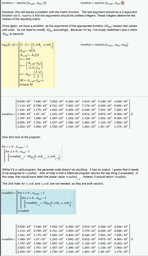

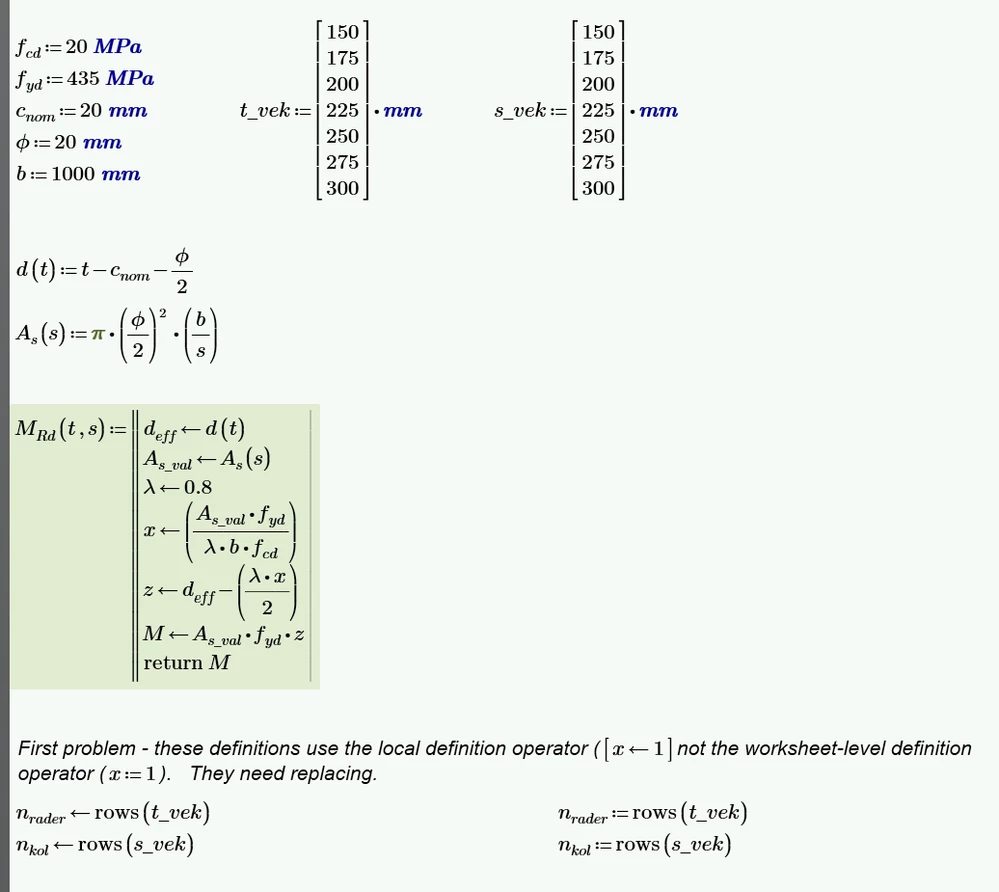

AI would still seem to have some way to go.  It has a number of "newbie" errors and misunderstandings.

If you want to continue using Prime for your work, I would advise you to familiarize yourself a little with how it works and its syntax using tutorials and help files, rather than letting AI do a (rather poor) job. Not everything in life is convenient and easy.
If you encounter problems and limitations during your own attempts, you can certainly get help here in the forum.
