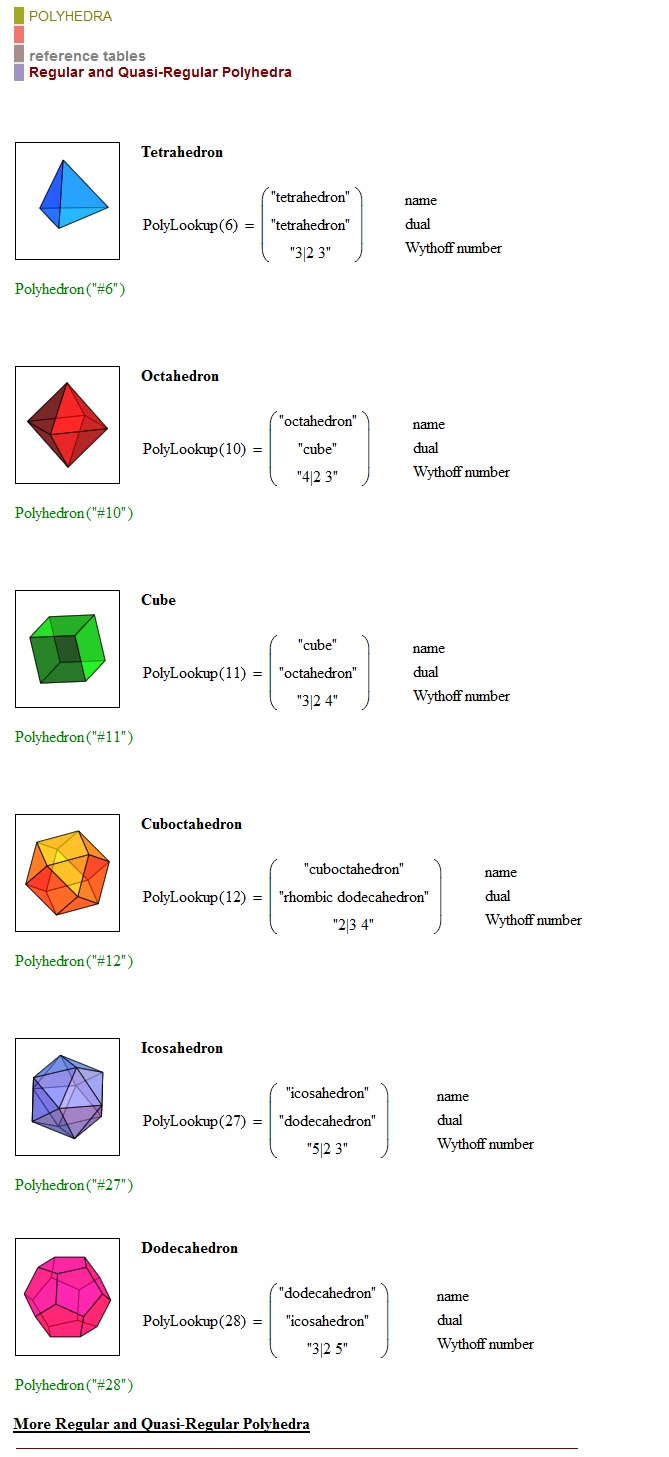

In mathcad 15 does not exist. There is, however, Polyhedron but it is another thing ...
as you can see from the following image:

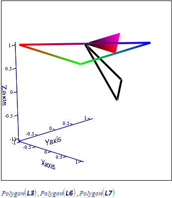

With a bit of further experimenting I found that the first three rows of the matrix that goes into the Polygon function contain the X, Y and Z-coordinates of the polygon points respectively. Further rows determine colour or the polygon.
Here are three examples:
And their results are:
The black (tilted w.r.t. the X/Y plane) triangle is associated with L3, the red/blue/green triangle is L6 (the subsequent rows of the matrix determine the values of red, blue and green on the respective points on a scale from 0 to 1 (any value above 1 or below 0 is discarded). The third triangle uses a 4-valued colour that I haven't figured out yet; I've set the display to fill the polygon with smooth shading.

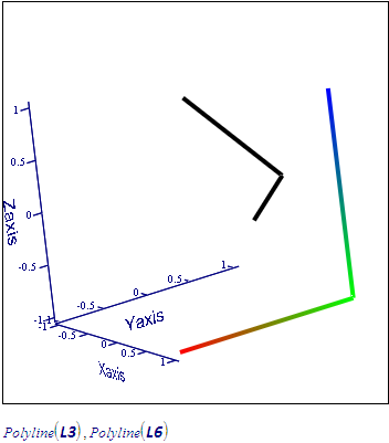

There also exists a Polyline function, that just draws a line from point to point, but the order of coordinates is unusual: Y,Z and then X. And it doesn't work with the four-valued colour (L7). The other two shapes from the same matrices above become:

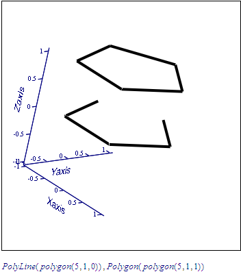

With a function polygon()
and PolyLine() that uses Polyline after rearranging the X,Y and Z-coordinates
I can now draw pentagons:
The polyline (incomplete) pentagon sits on level z=0, the full pentagon sits on level z=1.

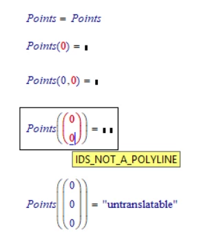

And now there appears to also exist a function Points() in Mathcad 11. It appears to be related to plotting as well.
November 30, 2017
And how does it look in MC11?
LucMeekes23-Emerald VAuthor
23-Emerald V
November 30, 2017
So far, I've tried only this:
All (3) errors are the same. Apparently the function requires vector(s) with (at least?) 3 elements.
The "untranslatable" is an indication that the function just wants to plot, it doesn't want to output numerical information; much like Polygon and Polyline.
