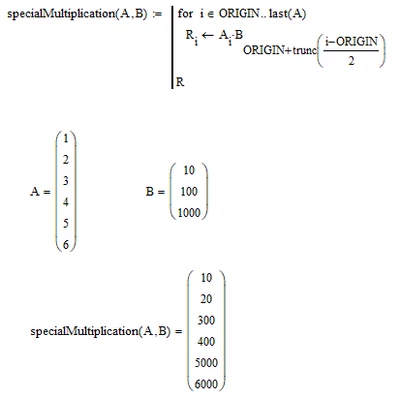

Unequal vector multiplication
I have a 4 row vector (A) and a 2 row vector (B) and I want to multiply the 1st two row elements of (A) each by the first element of (B) and the 3rd & 4th row elements of (A) each by the 2nd row element of (B). I want to do this element by element to give me a 4 row vector at the end. It's made more complicated by the fact the numbers of rows in both vectors can change although (A) will always have twice the number of rows as (B). I thought of trying to match the number of rows in (B) to (A) so I can simply multiply the two but not sure how to go about this.
Any help appreciated.

Here is a function which should do the job:
MC15 sheet attached

Thanks very much Werner, that works exactly how I was hoping it would!
I've only been using Mathcad/Prime for a relatively short time so it's great that this forum exists to help people out.
