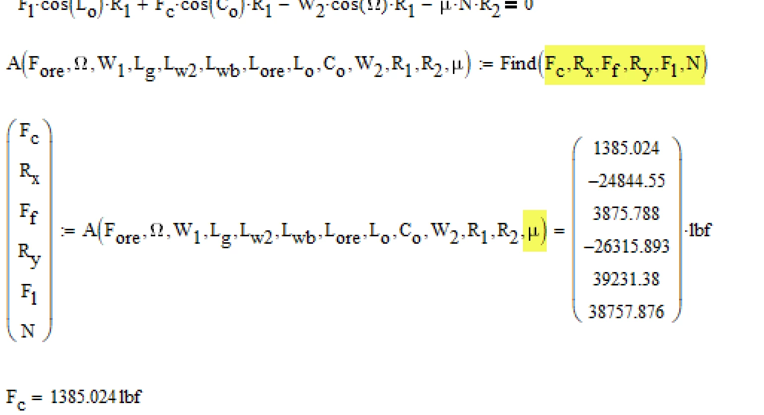

Hi, my solve block is returning a symbolic result rather than a number. What do I need to change to have it return a numerical result? Thank you.
Werner_EAnswer
1) You forgot the argument mu
2) You have to solve for ALL the variables which are supposed to vary
see attached picture
Werner_E25-Diamond IAnswer
Morto1-VisitorAuthor
Thanks Werner!
