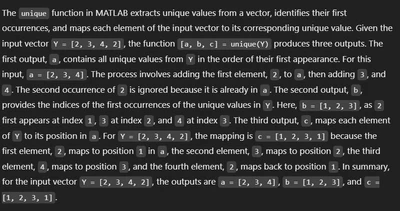

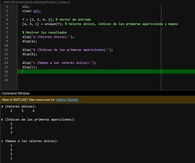

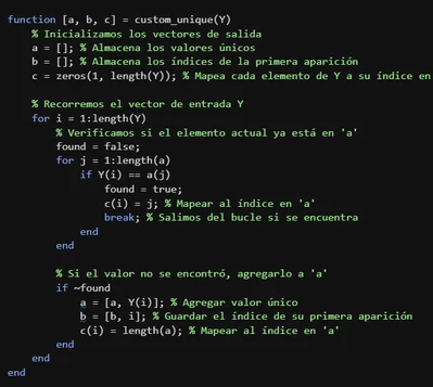

I want an algorithm that generates the function [a,b,c}=unique(Y) although there are forums what I need is for it to be only with structural control sequences if else for while etc but not advanced functions of either Matlab or from mathcad since when you want to replicate the function elsewhere it is complicated, it would be appreciated if you have a way to do it
What would the mathcad programming of this algorithm be like as it is in the image so it is easier to carry out the function?

What you posted is very C-like, and could easily convert this to a Custom Function DLL and simply add this to the Custom Functions folder for use.  There are examples of how to do this in the help. Of course, you need a C/C++ compiler.

Actually, it's easier than what I posted.  See this discussion here on unique functions: Yet another "unique" function and the NaN (Not a "... - PTC Community
