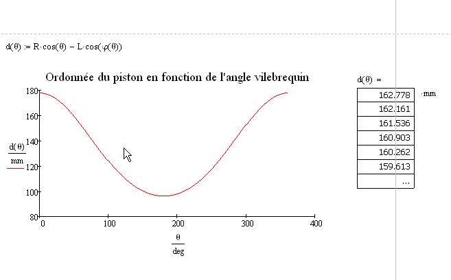

I look for change unit of X-Y Plot.
q := 0°,1°.. 360°
R := 24 mm
L := 128 mm
d(q) := R*cos(q)-L*cos(q)
when I draw d(q) by a X-Y plot the units are in rad for q and m for d(q).
Is it possible to draw a graph with a specific units ?

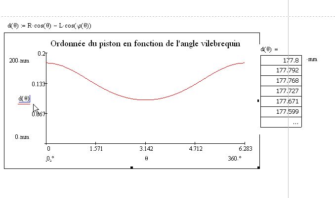

How did you do?
I must copy your graph in my sheet to obtain the good result.
Could you help me.
January 18, 2012
Simple explanation in the attached.
As I have already indicated, you just divide the variable by the required unit, using the / key.
Mike

As Norm has indicated in his example you just divide variable by the desired unit.
Mike
Lilli1-VisitorAuthor
January 18, 2012
I'm really afraid but I understand you explaination but don't know apply!
January 18, 2012
Have a look below.
Move the cursor to this position on the graph and then strike the / key and type the unit in. It should then look like this.
Another note. I had to change the limits of your graph to get it to work, watch out for that.
Mike
January 18, 2012
Perfect Mike!
Many thanks
