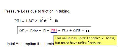

I was struggling with a strange problem in Mathcad.
First, I could not change the unit in the result.
Second, all the units in the equation are in same format, still it is showing error.
Please guide me how can I change the units to psi. I have attached my mathcad sheet.
This seems to be due to the fact that you don't have found a result yet as the expression throws an error.
Format? All the summands have to be of the same dimension but they aren't. So you sure have a unit mismatch:

Thanks for your response.
Problem is resolved.
