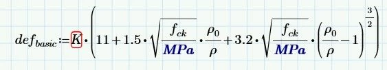

Hii,
     I am facing another error regarding the unit.
It shows that the units are not compatible. What it means and how to solve this?

Hi Arun,
It is another empirical equation using square root of f.ck do this:

@Arun_15 wrote:
Hii,
Regards
Arun
you add "problematic" expression to constant 11. Therefore the expression must be unitless ... please take a paper and pencil and check it.

The equation contains no unit for the numbers. Is there any other way to get the result?

Your expression can only work if f.ck is unitless and rho.0 and rho have the same unit. The simple reason is that you are adding the unitless 11 to parts involving those variables and subtracting the unitless 1 from the division of rho.0 and rho .
Next time, please attach the worksheet.

Thank you, Luc!
             Now It's clear. Will try.
