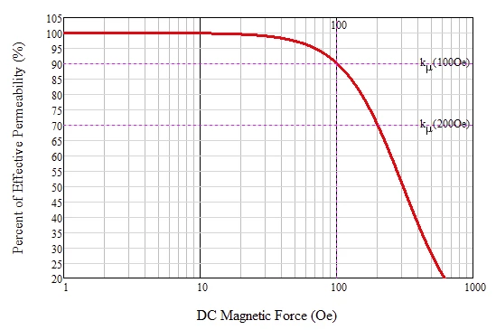

When plotting with units, its always a good idea to use a range variable for the abscissa values and not rely on Mathcads quickplot feature.
Define a range for the H.DC values (note, that when you define a range with units you have to specify all three values (first, second and last value) and apply the correct unit to each of them:
In the plot you don't have to specify the left- and rightmost values, you can leave the placeholders empty - the plot will use the limits of the range. But if you specify the limits in the plot, you have to do it without units!
Now for the way to let the H.DC values be displayed in Oe rather than the default units. In the placeholder for the abscissa values type H.DC and divide it by the desired unit, so you type H.DC/Oe. This should do the trick.
Also in the placeholders for the markers you must use scalars without units, so you have to use just "100" for the vertical marker and not "100 Oe".
Then you may format the plot by hiding the arguments, just showing the labels for each axis and you also may turn off "auto grid" for the y-axis and chose a more appropriate number of intervals:
Mathcad 15 sheet attached.

BIG help. Thanks. The result is what I want to get. Understand the details what you said. Thank you again!
