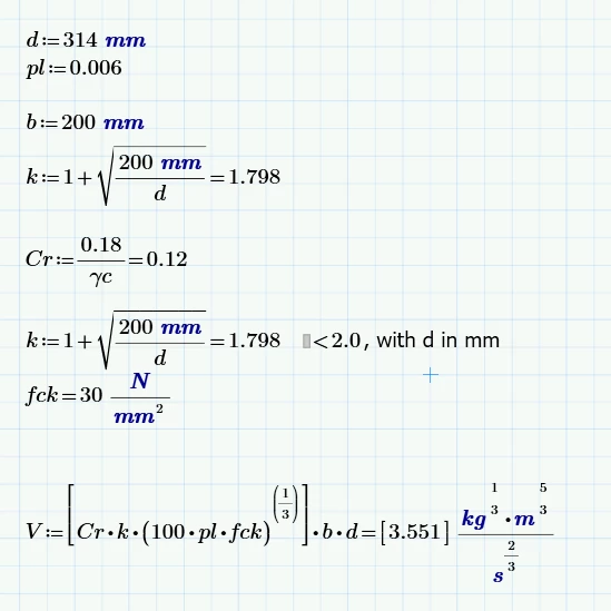

Hi, im using mathcad prime 4 and I have´some problems with the following equation. This i
This is my input values:
d=314 [mm]
b=200 [mm]
pl=0.006 [Unitless]
Cr=0.12 [Unitless]
k=1.798 [Unitless]
fck=30 [N/mm^2]
V=[Cr*k*(100*pl*fck)^(1/3)]*b*d, this equation gives me the unit [kg^(1/3)]*[m^(5/3)]/[s^(2/3)] but i want in to be in the unit N. I've tried to use [MPa] as a unit for fck and tried to write the unit manually but it doesn't work

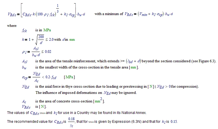

You formula comes from Eurocode.... Is it a formula derived from physics basics (in which case the units must balance), or is it an empirical formula (one that happens to describe the phenomenon, or just happens to work, but lacks a solid physical background)?
If it is an emprical formula, then you better work without Mathcad's units, and fill in the numbers per the instructions of the formula. If you search this forum for empirical, you will find tips on how to deal with empirical formulae.
If it is physically based, you better look up the meaning of all symbols and constants and their correct (SI) units.
23-Emerald V
April 15, 2018
Found it as formula in 6.2.2. of the EN 1991-1-1.
From the description I conclude that it's an empirical formula. Strip your units (by division with SIUnitsOf) of each of the input variables and apply the unit N to the result.

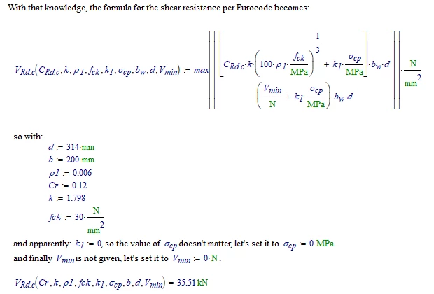

You're right, Werner...completely right.
Here's a way to work this. From the Eurocode I read:
