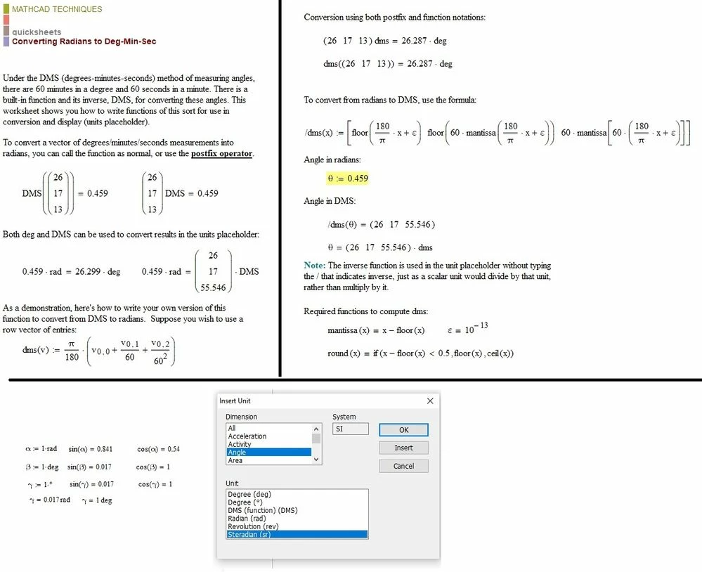

I cant believe mathcad 15 information is so poor i have to ask this
How do you define an ANGLE!!!
Not degrees C or F or K
I want to define a number like 50 degrees as in the angle 50 degrees!!!
Why is everything in this program so hard when it doesn't have to be

It doesn't have to be.  You can use the degree symbol (°) (alt-0176), but I usually just type deg in the units holder.
Once you learn the editor, and the program quirks, Mathcad is easy; it displays math just like you write it.

March 1, 2021
Mathcad 15.
