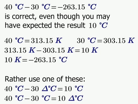

Temperature can be a beast if used with other units than Kelvin.
You have distinguish between absolute temperature and temperature difference. Prime has different units for both of them.
A temperature difference of 1 °C equals 1 K, but an absolute temperature of 1 °C equals 274.15 K.
That said, I guess that what you need is
and this would be the very same as
See here some example which maybe can explain the confusion
